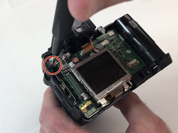

  6. FujiFilm FinePix S5100 Motherboard Replacement, LCD Screen: crwdns2935265:07crwdnd2935265:01crwdnd2935265:02crwdne2935265:0 FujiFilm FinePix S5100 Motherboard Replacement, LCD Screen: crwdns2935265:07crwdnd2935265:02crwdnd2935265:02crwdne2935265:0
    • Remove the two 1.3mm Phillips #000 screws from the LCD frame.
  7. FujiFilm FinePix S5100 Motherboard Replacement: crwdns2935265:08crwdnd2935265:01crwdnd2935265:02crwdne2935265:0 FujiFilm FinePix S5100 Motherboard Replacement: crwdns2935265:08crwdnd2935265:02crwdnd2935265:02crwdne2935265:0
    • Carefully using your hand, grab the LCD screen and pull upward and away from the motherboard.
    • Carefully using your hand, remove the tan digital tape by disconnecting it from the receiving port.
    • Remove the entire LCD screen from the motherboard.

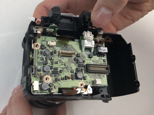

  9. FujiFilm FinePix S5100 Motherboard Replacement, Motherboard: crwdns2935265:010crwdnd2935265:01crwdnd2935265:02crwdne2935265:0 FujiFilm FinePix S5100 Motherboard Replacement, Motherboard: crwdns2935265:010crwdnd2935265:02crwdnd2935265:02crwdne2935265:0
    • Carefully grab and remove the upper level motherboard from the camera.

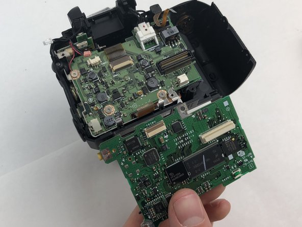

  10. FujiFilm FinePix S5100 Motherboard Replacement: crwdns2935265:011crwdnd2935265:01crwdnd2935265:01crwdne2935265:0
    • Remove three 0.8mm Phillips #000 screws from the motherboard.
  11. FujiFilm FinePix S5100 Motherboard Replacement: crwdns2935265:012crwdnd2935265:01crwdnd2935265:02crwdne2935265:0 FujiFilm FinePix S5100 Motherboard Replacement: crwdns2935265:012crwdnd2935265:02crwdnd2935265:02crwdne2935265:0
    • Carefully remove the tan digital tape from the receiving port.
  12. FujiFilm FinePix S5100 Motherboard Replacement: crwdns2935265:013crwdnd2935265:01crwdnd2935265:01crwdne2935265:0
    • Carefully remove the lower level motherboard from the camera and set aside.
