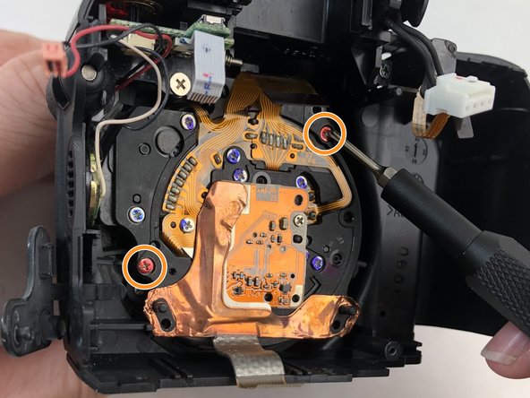

  13. FujiFilm FinePix S5100 Microphone Replacement, Lens Compartment: crwdns2935265:014crwdnd2935265:01crwdnd2935265:02crwdne2935265:0 FujiFilm FinePix S5100 Microphone Replacement, Lens Compartment: crwdns2935265:014crwdnd2935265:02crwdnd2935265:02crwdne2935265:0
    • Remove three 1.0mm Phillips #000 black screws from the back of the lens compartment.
    • Remove two 0.4mm Phillips #000 red screws from the back of the lens compartment.
