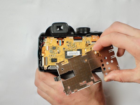

    • Flip up the black tab holding the LCD ribbon wire in place and remove wire.
  9. FujiFilm FinePix S4500 Viewfinder Replacement, Viewfinder: crwdns2935265:09crwdnd2935265:01crwdnd2935265:02crwdne2935265:0 FujiFilm FinePix S4500 Viewfinder Replacement, Viewfinder: crwdns2935265:09crwdnd2935265:02crwdnd2935265:02crwdne2935265:0
    • Remove the highlighted 2.7 mm Phillips #1 screws to release the metal cover.
