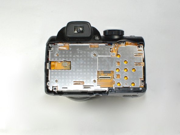

  7. FujiFilm FinePix S4500 LCD Replacement: crwdns2935265:07crwdnd2935265:01crwdnd2935265:01crwdne2935265:0
    • Use a plastic opening tool to separate the LCD screen from the camera.
  8. FujiFilm FinePix S4500 LCD Replacement: crwdns2935265:08crwdnd2935265:01crwdnd2935265:02crwdne2935265:0 FujiFilm FinePix S4500 LCD Replacement: crwdns2935265:08crwdnd2935265:02crwdnd2935265:02crwdne2935265:0
    • Flip up the black tab holding the LCD ribbon wire in place and remove wire.
