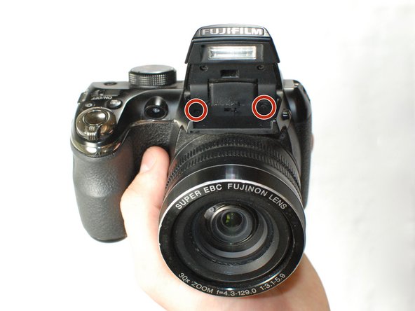

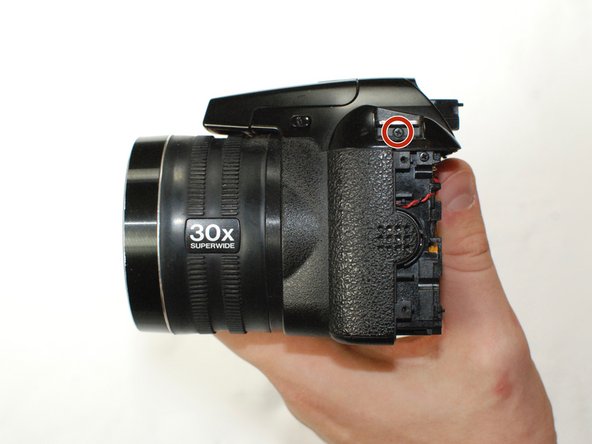

  9. FujiFilm FinePix S4500 Flash Springs Replacement, Flash Springs: crwdns2935265:09crwdnd2935265:01crwdnd2935265:03crwdne2935265:0 FujiFilm FinePix S4500 Flash Springs Replacement, Flash Springs: crwdns2935265:09crwdnd2935265:02crwdnd2935265:03crwdne2935265:0 FujiFilm FinePix S4500 Flash Springs Replacement, Flash Springs: crwdns2935265:09crwdnd2935265:03crwdnd2935265:03crwdne2935265:0
    • Remove the 3.5 mm Phillips #1 screws holding the top to allow access to the flash mechanism.
  10. FujiFilm FinePix S4500 Flash Springs Replacement: crwdns2935265:010crwdnd2935265:01crwdnd2935265:01crwdne2935265:0
    • Remove the top and use a screwdriver to remove the highlighted 2.7 mm Phillips #1 screws.
    • Remove the top cover of the flash.
