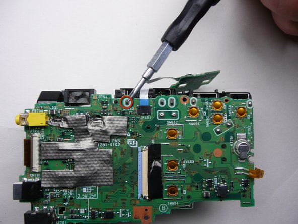

  9. FujiFilm FinePix A340 Flash Unit Replacement, Motherboard: crwdns2935265:09crwdnd2935265:01crwdnd2935265:01crwdne2935265:0
    • Remove the two screws holding the circuit board down.

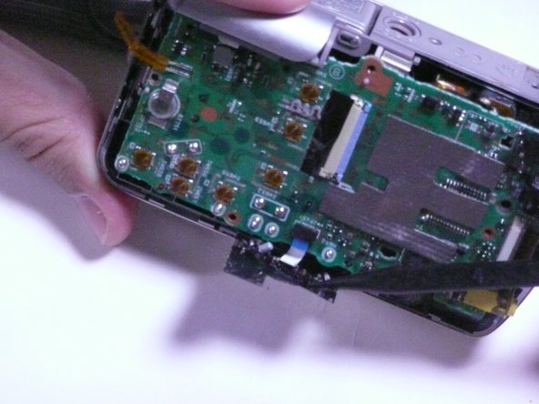

  10. FujiFilm FinePix A340 Flash Unit Replacement: crwdns2935265:010crwdnd2935265:01crwdnd2935265:02crwdne2935265:0 FujiFilm FinePix A340 Flash Unit Replacement: crwdns2935265:010crwdnd2935265:02crwdnd2935265:02crwdne2935265:0
    • Remove the black sticky tape from the circuit board and camera case.
  11. FujiFilm FinePix A340 Flash Unit Replacement: crwdns2935265:011crwdnd2935265:01crwdnd2935265:02crwdne2935265:0 FujiFilm FinePix A340 Flash Unit Replacement: crwdns2935265:011crwdnd2935265:02crwdnd2935265:02crwdne2935265:0
    • Gently pull the circuit board away from the front side of the camera.
    • Be careful when removing the assembly as to not break any solder leads or damage the lens assembly.

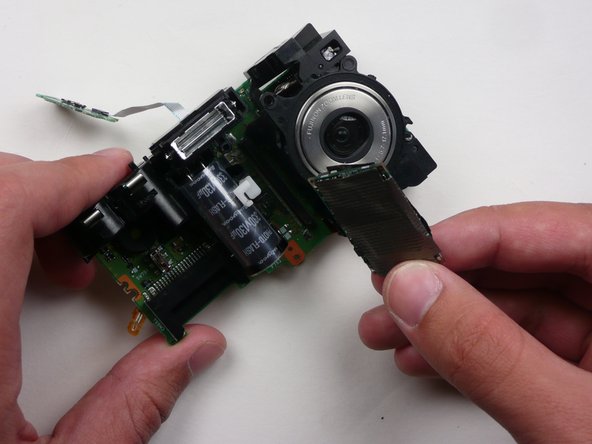

  12. FujiFilm FinePix A340 Flash Unit Replacement: crwdns2935265:012crwdnd2935265:01crwdnd2935265:02crwdne2935265:0 FujiFilm FinePix A340 Flash Unit Replacement: crwdns2935265:012crwdnd2935265:02crwdnd2935265:02crwdne2935265:0
    • Remove the motherboard by pulling it straight away from the assembly.

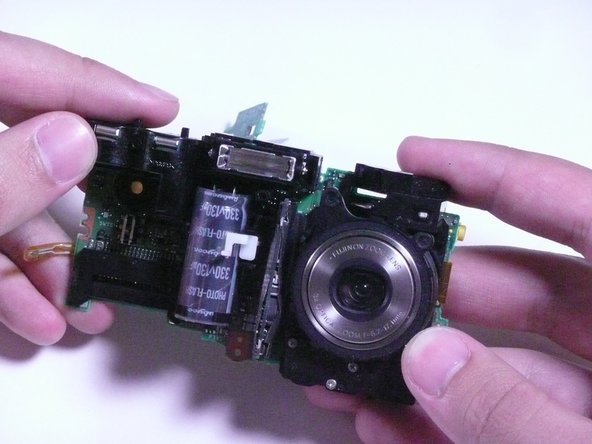

  13. FujiFilm FinePix A340 Flash Unit Replacement, Flash Unit: crwdns2935265:013crwdnd2935265:01crwdnd2935265:01crwdne2935265:0
    • Locate the flash unit of the camera. It includes the camera's flash and a capacitor.
  14. FujiFilm FinePix A340 Flash Unit Replacement: crwdns2935265:014crwdnd2935265:01crwdnd2935265:02crwdne2935265:0 FujiFilm FinePix A340 Flash Unit Replacement: crwdns2935265:014crwdnd2935265:02crwdnd2935265:02crwdne2935265:0
    • Desolder the flash unit at its three points.
    • Be careful not to damage the circuit board or surrounding parts with the solder iron.
