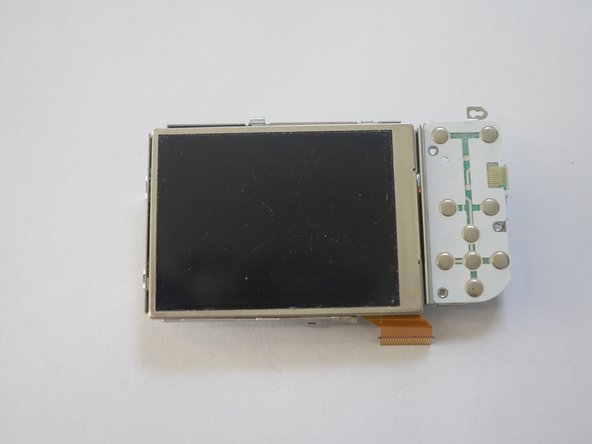

  3. FujiFilm AX655 LCD Replacement: crwdns2935265:03crwdnd2935265:01crwdnd2935265:02crwdne2935265:0 FujiFilm AX655 LCD Replacement: crwdns2935265:03crwdnd2935265:02crwdnd2935265:02crwdne2935265:0
    • Release the LCD flex cable from the ziff socket. Careful not to damage ziff clamp
    • Next swap out your old LCD with your new LCD and reverse the steps.
