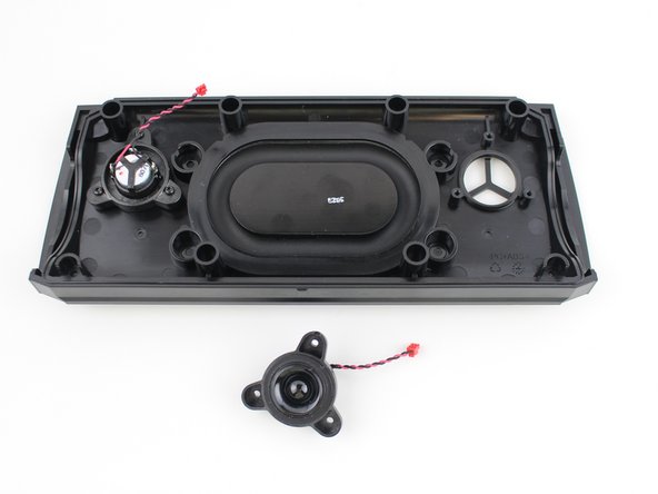

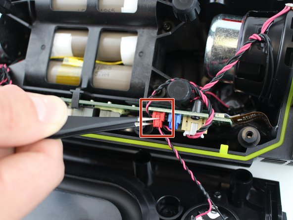

  6. Fugoo Tough XL Speaker Replacement, Speaker: crwdns2935265:06crwdnd2935265:01crwdnd2935265:02crwdne2935265:0 Fugoo Tough XL Speaker Replacement, Speaker: crwdns2935265:06crwdnd2935265:02crwdnd2935265:02crwdne2935265:0
    • Carefully untangle the wires that are connected from the speaker to the motherboard.
    • Using a tweezer, pull downwards on the base of each red speaker connector to remove them from the motherboard.

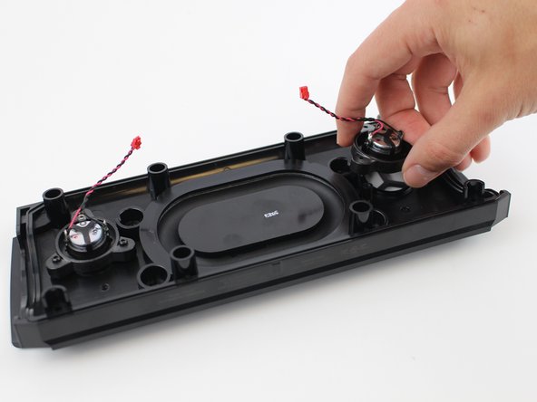

  7. Fugoo Tough XL Speaker Replacement: crwdns2935265:07crwdnd2935265:01crwdnd2935265:03crwdne2935265:0 Fugoo Tough XL Speaker Replacement: crwdns2935265:07crwdnd2935265:02crwdnd2935265:03crwdne2935265:0 Fugoo Tough XL Speaker Replacement: crwdns2935265:07crwdnd2935265:03crwdnd2935265:03crwdne2935265:0
    • Use a #3 Hex screwdriver to unscrew all six 3mm screws."
    • While holding the case with one hand, pull up on the speaker you wish to replace.
