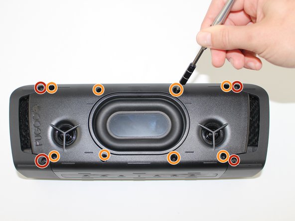

    • Remove the four 3 mm screws located in each corner using a 3 mm Hex screwdriver.
  2. Fugoo Tough XL Case Replacement: crwdns2935265:02crwdnd2935265:01crwdnd2935265:02crwdne2935265:0 Fugoo Tough XL Case Replacement: crwdns2935265:02crwdnd2935265:02crwdnd2935265:02crwdne2935265:0
    • Gently pull up and off the outer casing.
    • Do not feel afraid to use a bit of force if necessary.
  3. Fugoo Tough XL Case Replacement: crwdns2935265:03crwdnd2935265:01crwdnd2935265:02crwdne2935265:0 Fugoo Tough XL Case Replacement: crwdns2935265:03crwdnd2935265:02crwdnd2935265:02crwdne2935265:0
    • Remove the internal device from the outer casing.
    • Remove the four 12 mm screws on each corner using a T10 Torx screwdriver.
    • Remove the eight 6 mm screws on the top and bottom using a T10 Torx screwdriver.
  4. Fugoo Tough XL Case Replacement: crwdns2935265:04crwdnd2935265:01crwdnd2935265:03crwdne2935265:0 Fugoo Tough XL Case Replacement: crwdns2935265:04crwdnd2935265:02crwdnd2935265:03crwdne2935265:0 Fugoo Tough XL Case Replacement: crwdns2935265:04crwdnd2935265:03crwdnd2935265:03crwdne2935265:0
    • Use your hands to gently remove the side plates.
    • Use an opening tool to pry off the back plate with the Fugoo trademark.
  5. Fugoo Tough XL Case Replacement: crwdns2935265:05crwdnd2935265:01crwdnd2935265:01crwdne2935265:0
    • Slowly pull the front casing from the back casing. Avoid putting any tension on the connected cables.
    • Separate the two slowly and consistently to avoid damaging the speaker cables.
