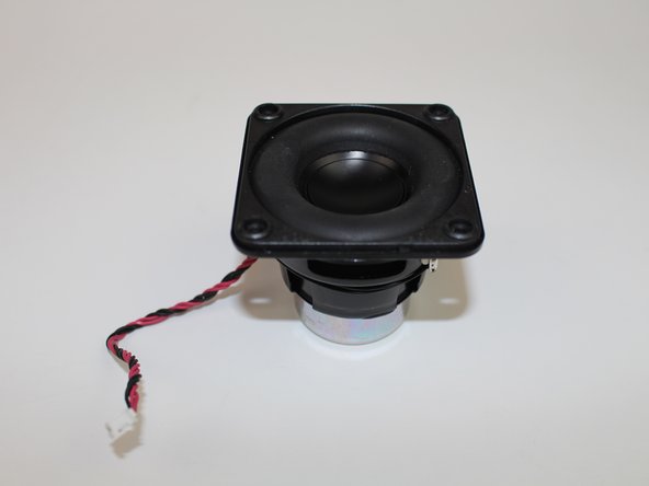

  10. Fugoo Tough XL Bass Speaker Replacement, Bass Speaker: crwdns2935265:010crwdnd2935265:01crwdnd2935265:01crwdne2935265:0
    • Remove four 3 mm screws using a 3 mm Hex screwdriver.
  11. Fugoo Tough XL Bass Speaker Replacement: crwdns2935265:011crwdnd2935265:01crwdnd2935265:02crwdne2935265:0 Fugoo Tough XL Bass Speaker Replacement: crwdns2935265:011crwdnd2935265:02crwdnd2935265:02crwdne2935265:0
    • Pull the bass speaker from the internal case.
