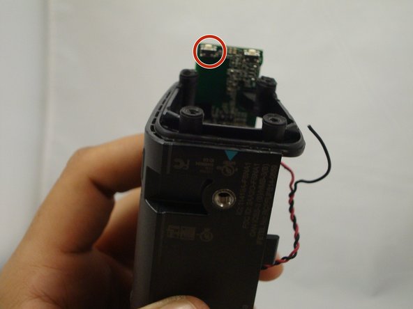

    • Begin by unscrewing the four 10.72 mm corner screws using the Hex 2.0 screwdriver.
    • Using the Hex 1.5 screwdriver, remove the remaining six 5.79 mm screws on the front of the speaker.
    • Pull the front part of shell away from the back part of shell.
  2. Fugoo Tough Power Button Replacement: crwdns2935265:02crwdnd2935265:01crwdnd2935265:03crwdne2935265:0 Fugoo Tough Power Button Replacement: crwdns2935265:02crwdnd2935265:02crwdnd2935265:03crwdne2935265:0 Fugoo Tough Power Button Replacement: crwdns2935265:02crwdnd2935265:03crwdnd2935265:03crwdne2935265:0
    • Change to the h1.3 head. Remove all four 5.57mm screws on both speaker covers.
    • Pull on the speaker covers to remove them.
    • Rotate the speaker 180 degrees and then remove the four 5.57 mm screws on the side speaker that has the power/bluetooth buttons.
    • Pull apart the side speaker and its casing away from the body of the Fugoo.
  3. Fugoo Tough Power Button Replacement: crwdns2935265:03crwdnd2935265:01crwdnd2935265:02crwdne2935265:0 Fugoo Tough Power Button Replacement: crwdns2935265:03crwdnd2935265:02crwdnd2935265:02crwdne2935265:0
    • After pulling apart the side speaker and its casing, you will see both the power and Bluetooth buttons on the underside of the circuit board.
    • Desolder the power button and replace it on the motherboard.
