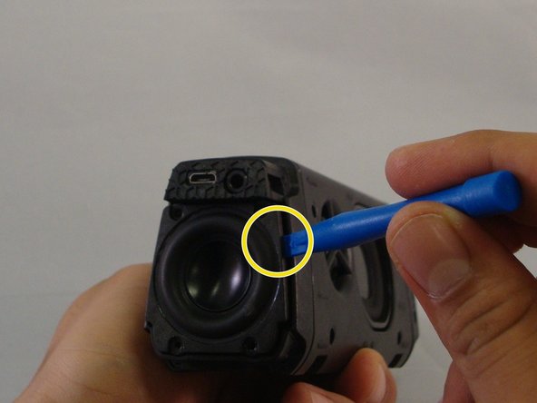

    • Have back of speaker facing you, remove 5-12.70mm screws using 1/16 flat head screwdriver.
    • Using the plastic opening tool you will be able to wedge back face of speaker off

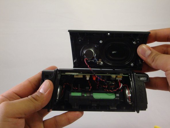

  4. Fugoo Tough Charging Port Replacement: crwdns2935265:04crwdnd2935265:01crwdnd2935265:02crwdne2935265:0 Fugoo Tough Charging Port Replacement: crwdns2935265:04crwdnd2935265:02crwdnd2935265:02crwdne2935265:0
    • The circuit board will be revealed, you will notice the various individual speaker connections to the circuit board.
    • Remove blue "clip" from the circuit board.

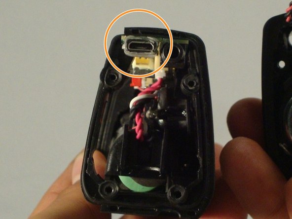

    • From this point, pull the side panel off gently, exposing the charging port.
    • At this time, you can remove the charging port and replace it.
