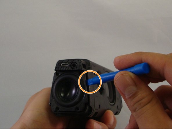

    • Begin by unscrewing the four 10.72mm corner screws using the Hex 2.0 screwdriver.
    • Using the Hex 1.5 screwdriver, remove the remaining six 5.79mm screws on the front of the speaker.
    • Pull the front part of shell away from the back part of shell.
  2. Fugoo Tough Battery Replacement: crwdns2935265:02crwdnd2935265:01crwdnd2935265:03crwdne2935265:0 Fugoo Tough Battery Replacement: crwdns2935265:02crwdnd2935265:02crwdnd2935265:03crwdne2935265:0 Fugoo Tough Battery Replacement: crwdns2935265:02crwdnd2935265:03crwdnd2935265:03crwdne2935265:0
    • Change to the h1.3 head. Remove all four 5.57mm screws on both speaker covers.
    • Pull on the speaker covers to remove them.
    • Rotate to side the speaker that has the charging port. Remove the four 5.57mm screws facing you.
    • Rotate the speaker 180 degrees and then remove the four 5.57 screws on the side speaker that has the power/bluetooth buttons.
  3. Fugoo Tough Battery Replacement: crwdns2935265:03crwdnd2935265:01crwdnd2935265:03crwdne2935265:0 Fugoo Tough Battery Replacement: crwdns2935265:03crwdnd2935265:02crwdnd2935265:03crwdne2935265:0 Fugoo Tough Battery Replacement: crwdns2935265:03crwdnd2935265:03crwdnd2935265:03crwdne2935265:0
    • Have back of speaker facing you, remove 5-12.70mm screws using 1/16 flat head screwdriver.
    • Using the plastic opening tool, you will be able to wedge back face of speaker off.

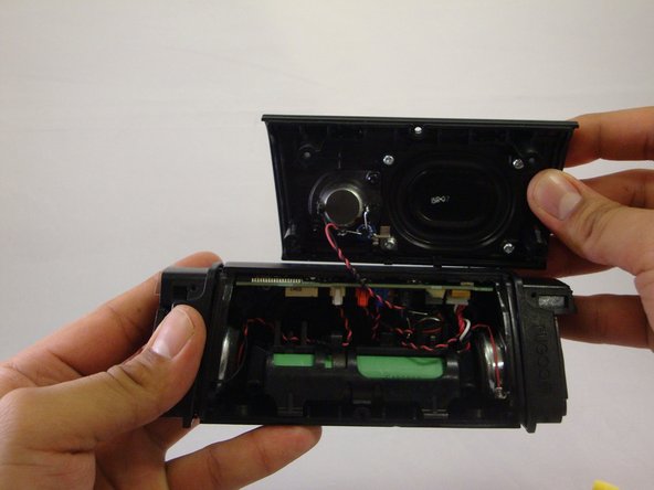

  4. Fugoo Tough Battery Replacement: crwdns2935265:04crwdnd2935265:01crwdnd2935265:03crwdne2935265:0 Fugoo Tough Battery Replacement: crwdns2935265:04crwdnd2935265:02crwdnd2935265:03crwdne2935265:0 Fugoo Tough Battery Replacement: crwdns2935265:04crwdnd2935265:03crwdnd2935265:03crwdne2935265:0
    • The circuit board will be revealed, you will notice the various clips/wires that go to the speakers and the battery
    • Remove the blue "clip" from the mother board, then pull the on the speaker and remove it, to give you more room to work
    • Gently pull down on the largest bundle of wires connected to the mother board by a white clip.
    • Battery isn't anchored down, you will be able to pull it out of device
    • The battery can now be replaced

what are the battery specs? where can one be purchased?
Miguel Tenorio - crwdns2934203:0crwdne2934203:0
Looks like an 18650 battery with wires soldered to a plastic housing that connects the 2 poles. The battery is slightly thicker but I think it's the wrap around it to keep it as a single unit. Mine just went bad so I'm going to try to swap it out. I'll update if I'm Successful.
Damian - crwdns2934203:0crwdne2934203:0
Update: Success! Worked beautifully. I'll put together some pix I took to wrap it up. If you kinda put it together and test it but the bass is all gone, give it a squeeze. Bass doesn't really show back up til you put screws back in.
What battery did you get? 18650? maH?
