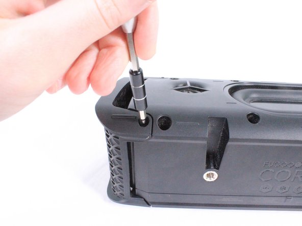

    • Using your hand, unscrew the large screws underneath the speaker.

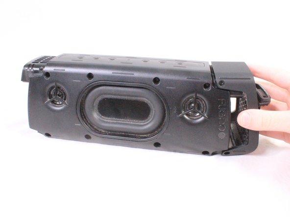

    • Using your hand, gently lift the large plastic tab secured to the rubber holding.
    • After lifting the tab, slide the speaker out of its case.
    • Ensure the tab is lifted only slightly above the rubber holding. Bending the plastic tab too far could result in damage to the case.

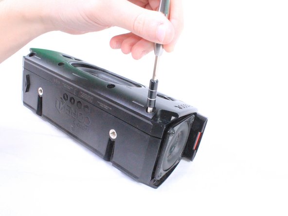

    • There are 8 screws (4 on each side) holding covers that conceal the bass speakers. Remove these 3mm screws using a #2.0 Hex screwdriver.

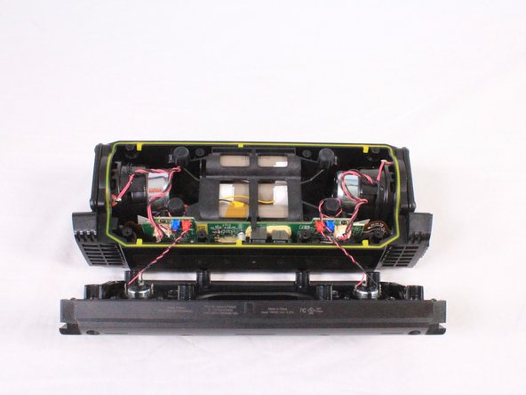

  6. Fugoo Style XL Speaker Replacement: crwdns2935265:06crwdnd2935265:01crwdnd2935265:02crwdne2935265:0 Fugoo Style XL Speaker Replacement: crwdns2935265:06crwdnd2935265:02crwdnd2935265:02crwdne2935265:0
    • Gently pull apart the front casing from the back casing.
    • Speakers on the front casing have wires directly connected to the motherboard. Pulling off the casing with force will result in damage.

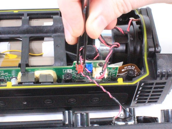

  7. Fugoo Style XL Speaker Replacement: crwdns2935265:07crwdnd2935265:01crwdnd2935265:02crwdne2935265:0 Fugoo Style XL Speaker Replacement: crwdns2935265:07crwdnd2935265:02crwdnd2935265:02crwdne2935265:0
    • Using a pair of tweezers or your hand, carefully remove the red bundled cable connectors from the motherboard.

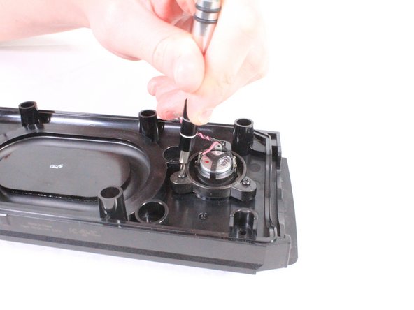

    • Each speaker is attached to the casing with 3mm screws. Remove the screws using a #2.0 Hex screwdriver.
    • Once the screws are removed, carefully lift the speaker from the casing.
