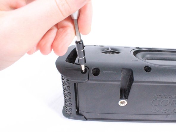

    • Using your hand, unscrew the large screws underneath the speaker.

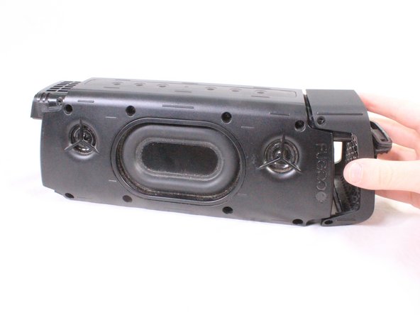

    • There are 8 screws (4 on each side) holding covers that conceal the bass speakers. Remove these 3mm screws using a #2.0 Hex screwdriver.

    • Using your hand, pull the covers away from the speaker.

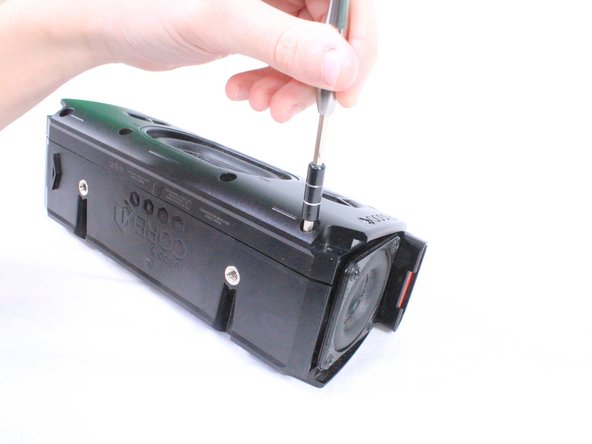

    • Using a #2.0 Hex screwdriver to unscrew the 8 12mm screws depicted.

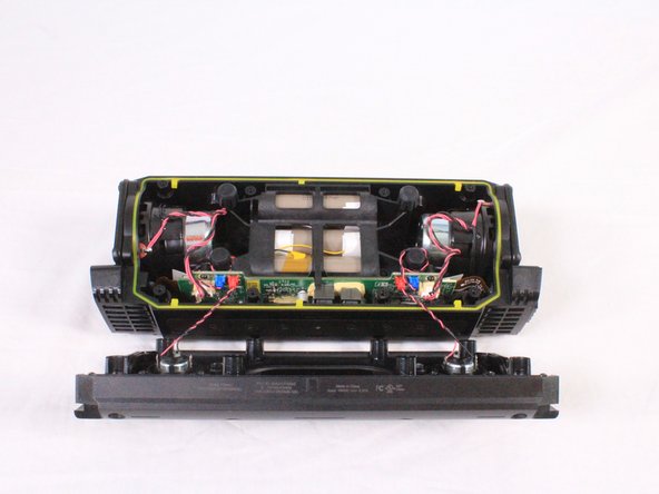

    • Gently pull apart the front casing from the back casing.
    • Speakers on the front casing have wires directly connected to the motherboard. Pulling off the casing with force will result in damage.

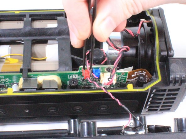

  7. Fugoo Style XL Midwoofer Replacement: crwdns2935265:07crwdnd2935265:01crwdnd2935265:02crwdne2935265:0 Fugoo Style XL Midwoofer Replacement: crwdns2935265:07crwdnd2935265:02crwdnd2935265:02crwdne2935265:0

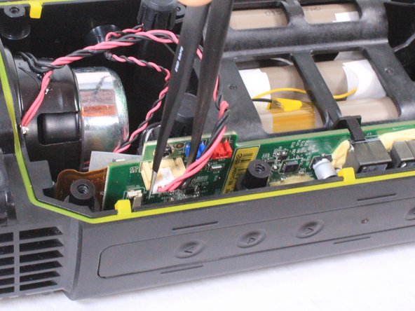

    • Using a pair of tweezers or your hand, carefully remove the red bundled cable connectors from the motherboard.
    • When the red bundled cable connectors are disconnected, set the outer casing aside.

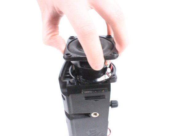

    • Using a T9 screwdriver, remove the 8 screws (4 on each speaker) surrounding the midwoofers.
    • Using your hand, carefully remove the midwoofers.
