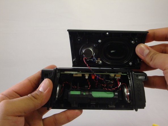

    • Begin by unscrewing the four 10.72mm corner screws using the Hex 2.0 screwdriver.
    • Using the Hex 1.5 screwdriver, remove the remaining six 5.79mm screws on the front of the speaker.
    • Pull the front part of shell away from the back part of shell.

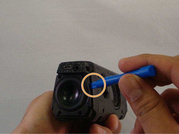

    • Have back of speaker facing you, remove 5-12.70mm screws using 1/16 flat head screwdriver.
    • Using the plastic opening tool you will be able to wedge back face of speaker off.

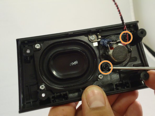

    • The circuit board will be revealed, you will notice the various individual speaker connections to the circuit board.
    • Remove black "clip" from the circuit board. Using the T9 screwdriver head remove the 2-7.20mm screws, and remove the speaker from the body of the device
