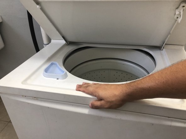

    • Using a metal pry tool (such as a putty knife) pry open the washer's top panel.
    • Go around the gap of the top panel with the metal pry tool and gently lift it up.
    • There are three clips holding the top panel in place: one in the front and the other two at the sides.
    • Use minimum force as you lift because the clips are plastic and can break.

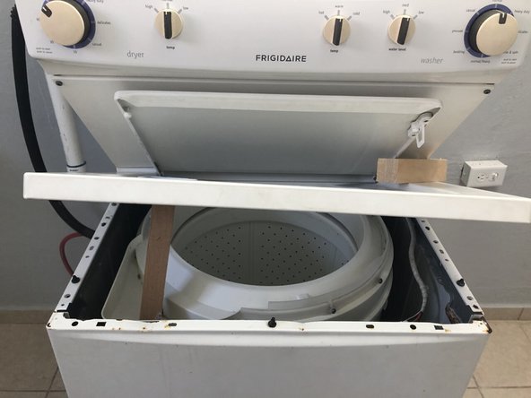

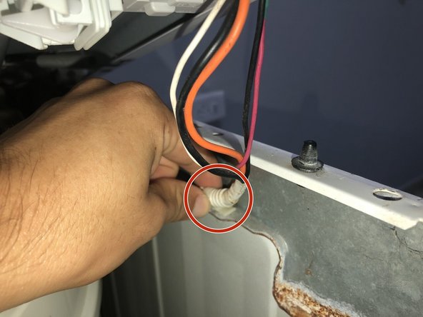

    • As you lift the top panel you will notice that there isn't much space. To solve this, remove the plastic clip holding the wiring harness in place with your fingers.
    • Using pliers to remove the clip could end up breaking it.
    • Lift the top panel completely and prop it open using something sturdy like a piece of wood.

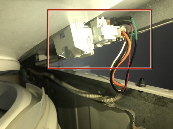

    • Hold the switch assembly tight with one hand and remove the three electrical connectors from the assembly with the other hand.
    • Lift the washer lid and prop it open using something sturdy like a piece of wood.
    • Take a photo of the electrical connections before removing them. This will help you later when reassembling.

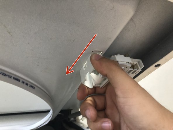

    • Use a rubber hammer to gently tap the switch assembly until it slides to the front.
    • Remove the switch assembly.

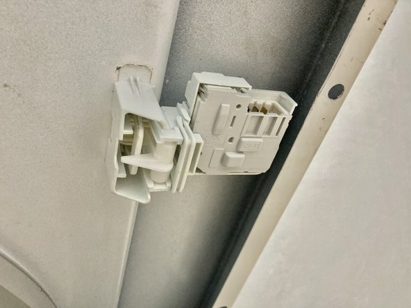

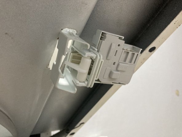

    • Purchase your new part and make sure it's the same as the old one. Pay attention to the metal pins where the connectors go as those tend to change from brand to brand.
    • Position the switch assembly in the slotted hole and then slide it in place until your hear a click.
    • Do not use a rubber hammer in this step; doing so may damage the switch assembly.
