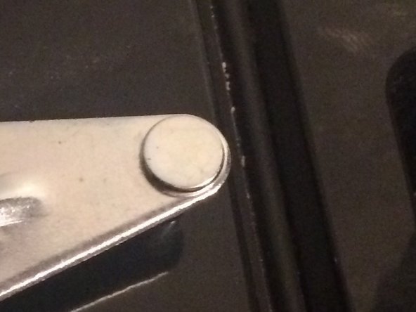

  1. Frigidaire FFPE45B2QM Refrigerator Door Replacement, Broken Hinge: crwdns2935265:01crwdnd2935265:01crwdnd2935265:01crwdne2935265:0
    • Carefully pop off the cover using a spudger or other opening tool.
  2. Frigidaire FFPE45B2QM Refrigerator Door Replacement: crwdns2935265:02crwdnd2935265:01crwdnd2935265:01crwdne2935265:0
    • Use a JIS #1 screw driver to remove both 25mm bolts that are attaching the door to the refrigerator.
  3. Frigidaire FFPE45B2QM Refrigerator Door Replacement: crwdns2935265:03crwdnd2935265:01crwdnd2935265:02crwdne2935265:0 Frigidaire FFPE45B2QM Refrigerator Door Replacement: crwdns2935265:03crwdnd2935265:02crwdnd2935265:02crwdne2935265:0
    • Remove the damaged hinge. Make sure that you don't lose the bolt that goes into the door.
  4. Frigidaire FFPE45B2QM Refrigerator Door Replacement, Refrigerator Door: crwdns2935265:04crwdnd2935265:01crwdnd2935265:01crwdne2935265:0
    • Remove the door by slowly lifting straight up, put the door off to the side.
  5. Frigidaire FFPE45B2QM Refrigerator Door Replacement: crwdns2935265:05crwdnd2935265:01crwdnd2935265:01crwdne2935265:0
    • Get a new, non-damaged door.

So this is a 4.5 cubic foot mini-refrigerator. I suppose the door was damaged in moving the refrigerator - maybe dropped because it has a weight of 58 pounds.
