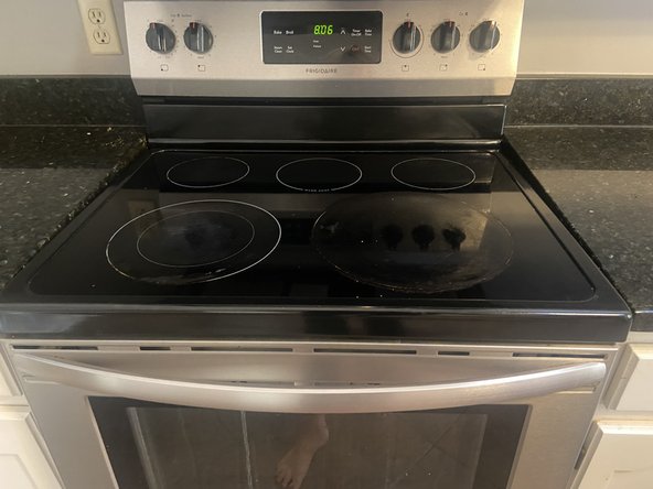

Frigidaire FCRE3052A Oven Light Replacement
  1. Frigidaire FCRE3052A Oven Light Replacement, Oven Light: crwdns2935265:01crwdnd2935265:01crwdnd2935265:03crwdne2935265:0 Frigidaire FCRE3052A Oven Light Replacement, Oven Light: crwdns2935265:01crwdnd2935265:02crwdnd2935265:03crwdne2935265:0 Frigidaire FCRE3052A Oven Light Replacement, Oven Light: crwdns2935265:01crwdnd2935265:03crwdnd2935265:03crwdne2935265:0

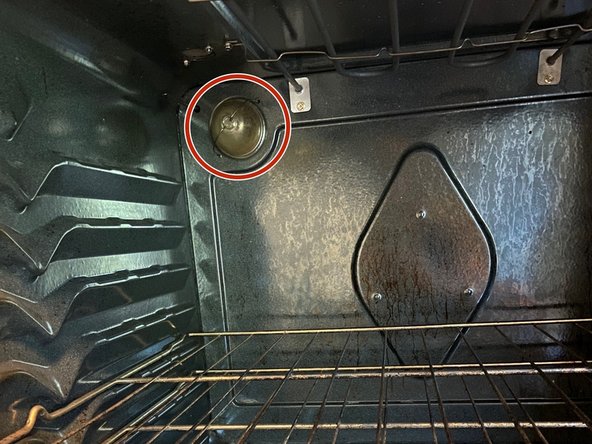

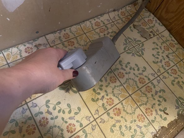

    • Unplug the oven carefully.

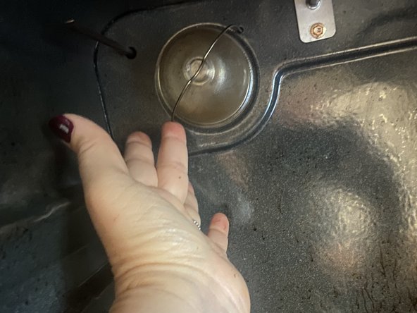

    • Open the oven and locate the light on the upper left side at the back of the oven.
  2. Frigidaire FCRE3052A Oven Light Replacement: crwdns2935265:02crwdnd2935265:01crwdnd2935265:03crwdne2935265:0 Frigidaire FCRE3052A Oven Light Replacement: crwdns2935265:02crwdnd2935265:02crwdnd2935265:03crwdne2935265:0 Frigidaire FCRE3052A Oven Light Replacement: crwdns2935265:02crwdnd2935265:03crwdnd2935265:03crwdne2935265:0

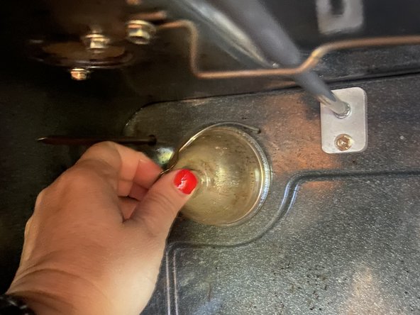

    • Slide the securing wire over the glass cover.
    • Remove the glass cover and set it aside.

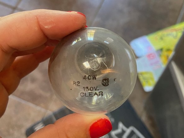

  3. Frigidaire FCRE3052A Oven Light Replacement: crwdns2935265:03crwdnd2935265:01crwdnd2935265:03crwdne2935265:0 Frigidaire FCRE3052A Oven Light Replacement: crwdns2935265:03crwdnd2935265:02crwdnd2935265:03crwdne2935265:0 Frigidaire FCRE3052A Oven Light Replacement: crwdns2935265:03crwdnd2935265:03crwdnd2935265:03crwdne2935265:0
    • Gently twist the old light bulb to the left to unscrew it, then remove it from the oven.
    • Replace it with the new bulb, twisting it to the right until it is securely in place.

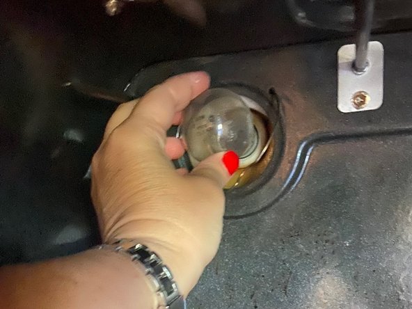

  4. Frigidaire FCRE3052A Oven Light Replacement: crwdns2935265:04crwdnd2935265:01crwdnd2935265:03crwdne2935265:0 Frigidaire FCRE3052A Oven Light Replacement: crwdns2935265:04crwdnd2935265:02crwdnd2935265:03crwdne2935265:0 Frigidaire FCRE3052A Oven Light Replacement: crwdns2935265:04crwdnd2935265:03crwdnd2935265:03crwdne2935265:0

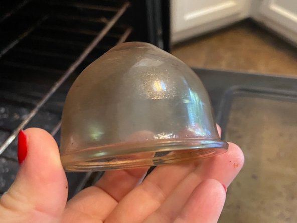

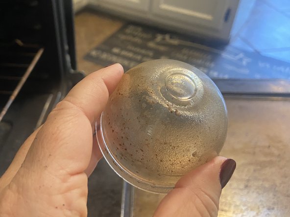

    • Before replacing the glass cover, consider cleaning it if it has significant grease or grime buildup.
    • Replace the glass cover back over the light bulb.
    • Slide the securing wire across the top of the glass cover to hold it in place.
    • Ensure that the glass cover and wire are securely in place.

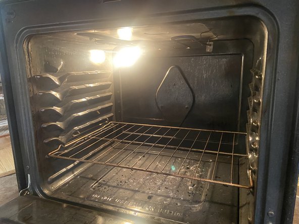

  6. Frigidaire FCRE3052A Oven Light Replacement: crwdns2935265:06crwdnd2935265:01crwdnd2935265:02crwdne2935265:0 Frigidaire FCRE3052A Oven Light Replacement: crwdns2935265:06crwdnd2935265:02crwdnd2935265:02crwdne2935265:0

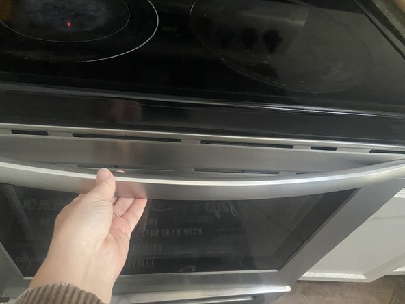

    • Open the oven door to confirm that the new light is working properly.
