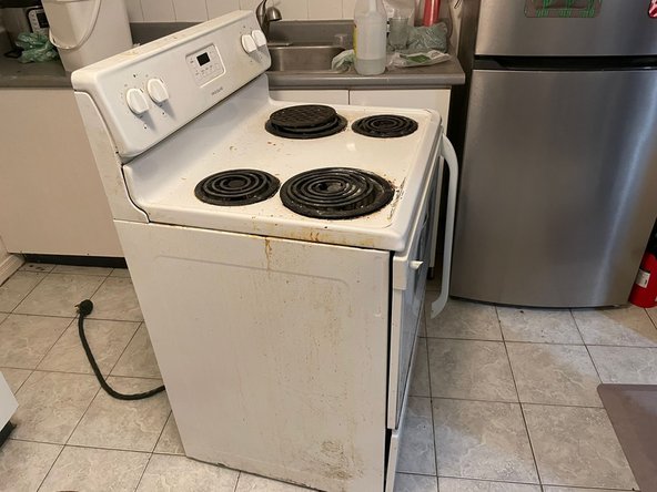

    • Unplug the oven from the receptacle to be safe.
    • Move it to an open area so there is enough space to work with.

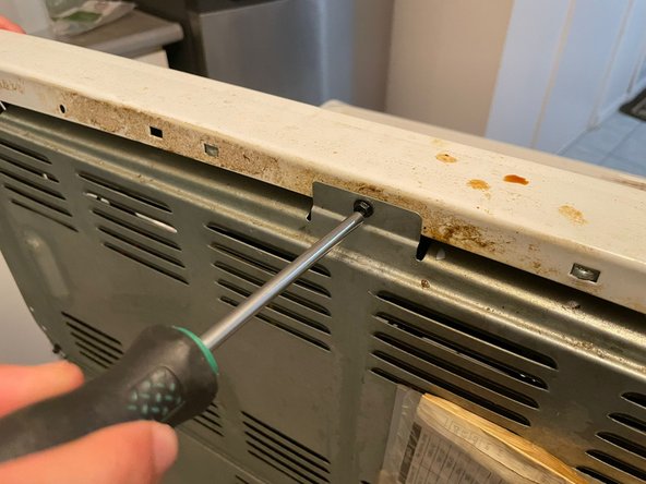

    • Unscrew the panel from the back. You may have a top or bottom cover, depending on your model.
    • The screwdriver used should be a square head.
    • If the screws are tight, use pliers to remove them.

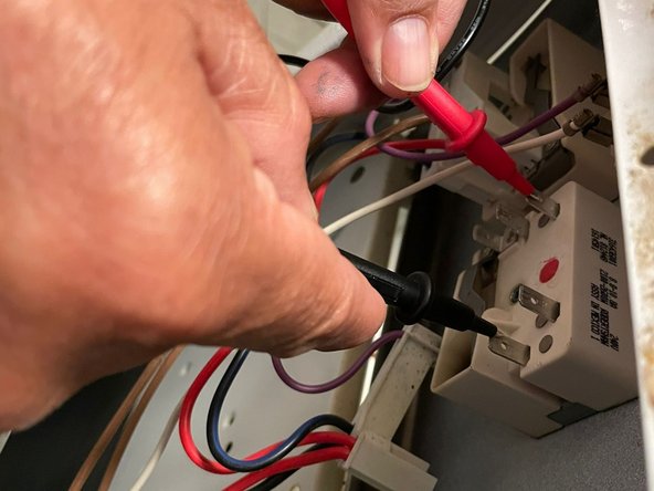

    • Set the multimeter to ohms. Otherwise, you may generate a short circuit if you do not have the correct setting.

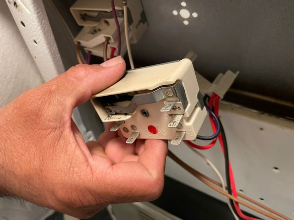

    • You must disconnect the wires to prevent electrical issues from occurring.
    • Remember where the original wires were placed. It's good to take a photo before doing so.

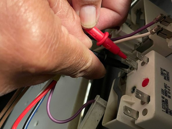

    • Look at the switch for the terminals. This differs depending if you have a standard surface element or a dual ring element(dual burner). But, it will be labeled.
    • In this case, the L1 to H1 and L2 to H2 terminals will be checked. (L=line, H=heat). Black goes on L and Red goes on H. The position may differ depending on your switch. Read the label on your switch.

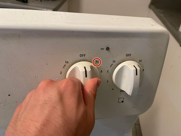

    • Once you've figured that out, make sure to turn your heat dial to HI
  7. Frigidaire CFEF3012PWC Heat Switch Repair: crwdns2935265:07crwdnd2935265:01crwdnd2935265:02crwdne2935265:0 Frigidaire CFEF3012PWC Heat Switch Repair: crwdns2935265:07crwdnd2935265:02crwdnd2935265:02crwdne2935265:0
    • Check the switch for the L1 to H1 terminals
  8. Frigidaire CFEF3012PWC Heat Switch Repair: crwdns2935265:08crwdnd2935265:01crwdnd2935265:02crwdne2935265:0 Frigidaire CFEF3012PWC Heat Switch Repair: crwdns2935265:08crwdnd2935265:02crwdnd2935265:02crwdne2935265:0
    • Check the switch for the L2 to H2 terminals.
  9. Frigidaire CFEF3012PWC Heat Switch Repair: crwdns2935265:09crwdnd2935265:01crwdnd2935265:01crwdne2935265:0
    • If it does not read from 0 to 1, you must replace the switch because there is no continuity.
  10. Frigidaire CFEF3012PWC Heat Switch Repair: crwdns2935265:010crwdnd2935265:01crwdnd2935265:01crwdne2935265:0
    • If you have a dual ring element then you can check the connectivity between the pairings for it. In this case, it is not present in either side of the back.
    • You may have other power models, but the process remains the same. If there is no connectivity, it has to be replaced.

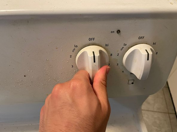

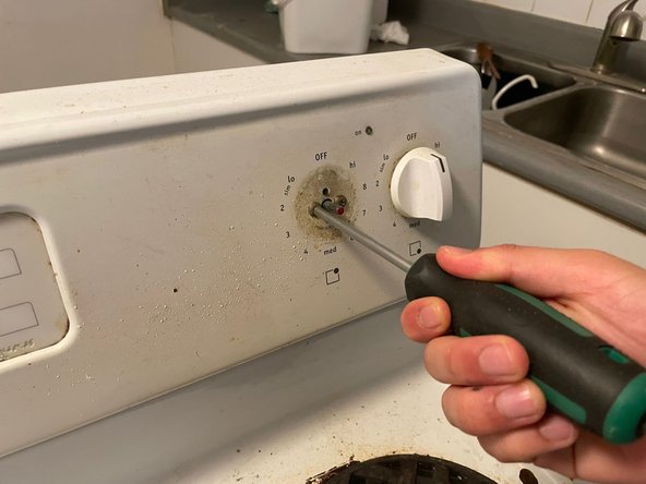

    • Once the switch has been confirmed to be faulty, Pull the heat dial out and remove the screws.

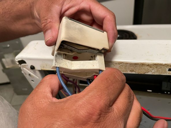

  12. Frigidaire CFEF3012PWC Heat Switch Repair: crwdns2935265:012crwdnd2935265:01crwdnd2935265:03crwdne2935265:0 Frigidaire CFEF3012PWC Heat Switch Repair: crwdns2935265:012crwdnd2935265:02crwdnd2935265:03crwdne2935265:0 Frigidaire CFEF3012PWC Heat Switch Repair: crwdns2935265:012crwdnd2935265:03crwdnd2935265:03crwdne2935265:0

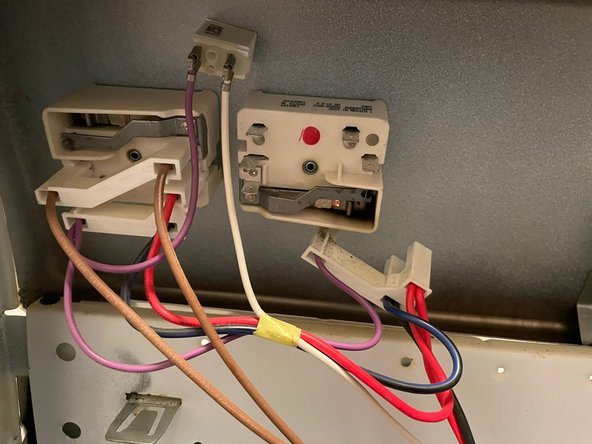

    • Now that the heat dial is removed, you can easily remove the switch and then connect the new switch to the dial.
    • Connect the wires in the same position you had seen with the old switch.
