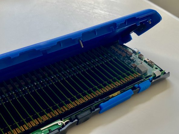

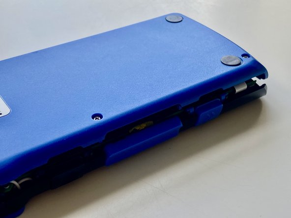

  2. Freedom Scientific Focus Blue 4th Gen Disassembly, Remove Back Plate: crwdns2935265:02crwdnd2935265:01crwdnd2935265:03crwdne2935265:0 Freedom Scientific Focus Blue 4th Gen Disassembly, Remove Back Plate: crwdns2935265:02crwdnd2935265:02crwdnd2935265:03crwdne2935265:0 Freedom Scientific Focus Blue 4th Gen Disassembly, Remove Back Plate: crwdns2935265:02crwdnd2935265:03crwdnd2935265:03crwdne2935265:0
    • Remove the 4 PH1 bolts from the bottom of the device.
    • The back plate is hinged at the top of the device back. Carefully rotate the back plate upwards and remove.
    • Note: All 4 bolts are the same size.
    • Note: The buttons will fall out if the device is rotated upside down.

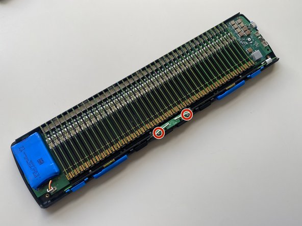

  3. Freedom Scientific Focus Blue 4th Gen Disassembly, Disconnect Battery: crwdns2935265:03crwdnd2935265:01crwdnd2935265:01crwdne2935265:0
    • Disconnect the battery by unplugging it.
    • Note: The battery is usually stuck to the motherboard with double sided tape.

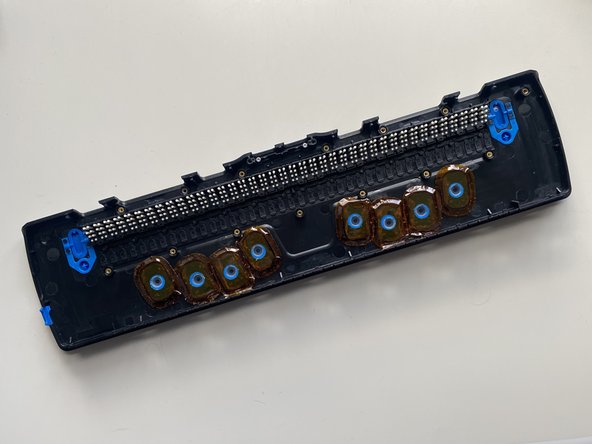

  4. Freedom Scientific Focus Blue 4th Gen Disassembly, Remove the Front Buttons Circuit: crwdns2935265:04crwdnd2935265:01crwdnd2935265:02crwdne2935265:0 Freedom Scientific Focus Blue 4th Gen Disassembly, Remove the Front Buttons Circuit: crwdns2935265:04crwdnd2935265:02crwdnd2935265:02crwdne2935265:0
    • Remove the 4 PH00 bolts securing the front buttons circuit board.
    • Remove the 2 T5 screws securing the spacebar switch.

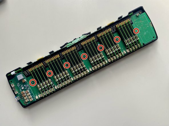

  5. Freedom Scientific Focus Blue 4th Gen Disassembly, Remove the Main Circuit Board: crwdns2935265:05crwdnd2935265:01crwdnd2935265:02crwdne2935265:0 Freedom Scientific Focus Blue 4th Gen Disassembly, Remove the Main Circuit Board: crwdns2935265:05crwdnd2935265:02crwdnd2935265:02crwdne2935265:0
    • Gently using a Size 1 Flat Head lever remove the cells from their sockets as shown to access the mainboard screws below.
    • Remove the 7 PH00 screws from the main circuit board.
    • Note: To reinstall the cells insert it back between the pins and gently push down on the connector.
  6. Freedom Scientific Focus Blue 4th Gen Disassembly, Remove the mainboard: crwdns2935265:06crwdnd2935265:01crwdnd2935265:02crwdne2935265:0 Freedom Scientific Focus Blue 4th Gen Disassembly, Remove the mainboard: crwdns2935265:06crwdnd2935265:02crwdnd2935265:02crwdne2935265:0
    • Carefully lift out the main board. Be careful with the power supply daughter board which is slotted in place to the case.
    • Disconnect as necessary.
