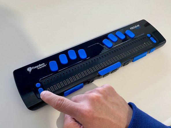

    • If on, power off the unit by holding the side power button for 3 seconds.
    • Enter the display test mode by holding power button and the two right most cursor keys for 3 seconds.
    • All the dots/pins of the braille display should raise.

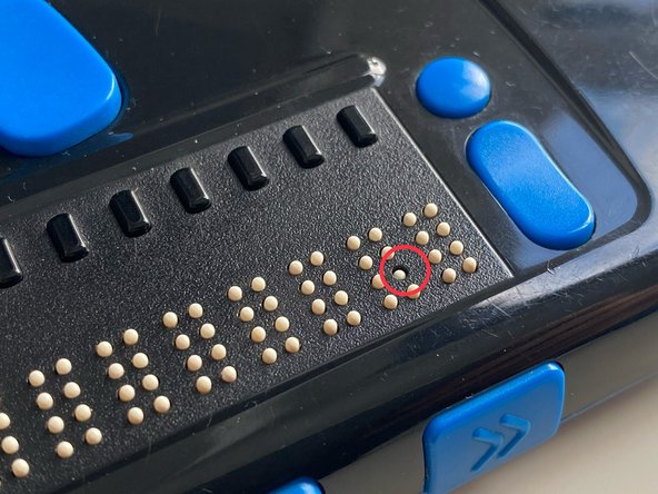

    • If any dots/pins appear to be stuck you can make the braille display toggle them using the mode key.
    • You can use the left or right rocker below the mode key to raise or lower all the dots.
  3. Freedom Scientific Focus Blue 4th Gen Cleaning, Look for Stuck Pins: crwdns2935265:03crwdnd2935265:01crwdnd2935265:02crwdne2935265:0 Freedom Scientific Focus Blue 4th Gen Cleaning, Look for Stuck Pins: crwdns2935265:03crwdnd2935265:02crwdnd2935265:02crwdne2935265:0
    • Raise and lower the pins/dots to check for any that are stuck up or down (see photos).
    • Some pins may wobble or make an electrical crackling noise. This may resolve itself after toggling the pin a few times and cleaning.
