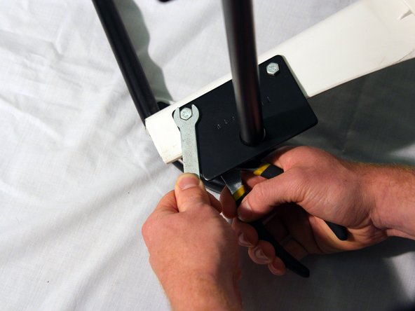

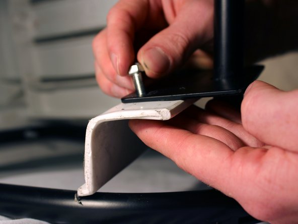

  6. Free Wheelchair Mission GEN 1 Teardown, Remove Axle Plates: crwdns2935265:06crwdnd2935265:01crwdnd2935265:03crwdne2935265:0 Free Wheelchair Mission GEN 1 Teardown, Remove Axle Plates: crwdns2935265:06crwdnd2935265:02crwdnd2935265:03crwdne2935265:0 Free Wheelchair Mission GEN 1 Teardown, Remove Axle Plates: crwdns2935265:06crwdnd2935265:03crwdnd2935265:03crwdne2935265:0
    • Turn the chair around to see the two base plates that hold the axle to the back of the chair. There are two screws on each of the plates that connect the chair to the axle.
    • Hold the nut with a 10 mm wrench in one hand. In the other hand, use a wrench to remove the screw.

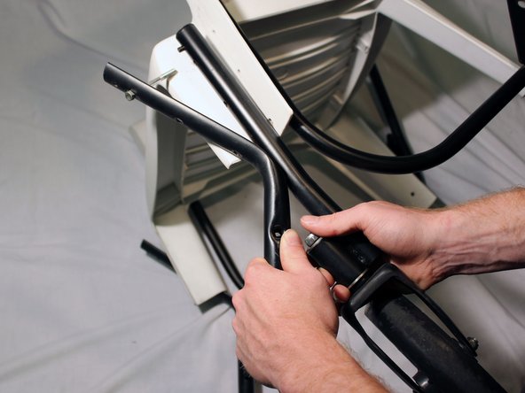

  7. Free Wheelchair Mission GEN 1 Teardown, Remove Front Frame and Castor Wheels: crwdns2935265:07crwdnd2935265:01crwdnd2935265:02crwdne2935265:0 Free Wheelchair Mission GEN 1 Teardown, Remove Front Frame and Castor Wheels: crwdns2935265:07crwdnd2935265:02crwdnd2935265:02crwdne2935265:0
    • Next you'll remove the screws that hold the back frame, chair, castor wheel, and front frame together. There is one screw on each side of the chair immediately above where the brakes are located.
    • Remove both of these screws using a 10 mm wrench.
    • Separate the front frame and and the castor wheel from the chair.
  8. Free Wheelchair Mission GEN 1 Teardown, Remove Chair: crwdns2935265:08crwdnd2935265:01crwdnd2935265:01crwdne2935265:0
    • Remove the chair from the frame.
