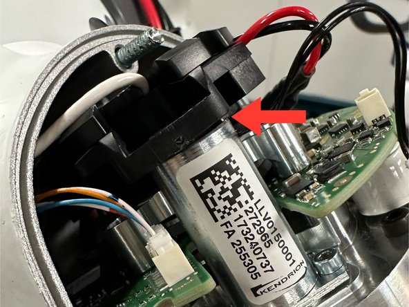

  2. Franka Emika Panda Robot Electromagnetic Locking System (Brake) Replacement, Confirm the locking solenoid as the culprit: crwdns2935265:02crwdnd2935265:01crwdnd2935265:03crwdne2935265:0 Franka Emika Panda Robot Electromagnetic Locking System (Brake) Replacement, Confirm the locking solenoid as the culprit: crwdns2935265:02crwdnd2935265:02crwdnd2935265:03crwdne2935265:0 Franka Emika Panda Robot Electromagnetic Locking System (Brake) Replacement, Confirm the locking solenoid as the culprit: crwdns2935265:02crwdnd2935265:03crwdnd2935265:03crwdne2935265:0
    • The location of the locking solenoid is illustrated with the red box.
    • Confirm that the solenoid is indeed broken by attempting to unlock the robot through Franka Desk UI.
    • The bronze pin (purple box) should actuate upon unlocking and stay in the "up" position. In a broken solenoid, the pin will not stay up.
    • The green box shows the "up" position of a functional solenoid. Note that the bronze pin is no longer flush with the lower part of the black cap.
    • See step 7 of the guide for a video of the nominal unlock behavior.

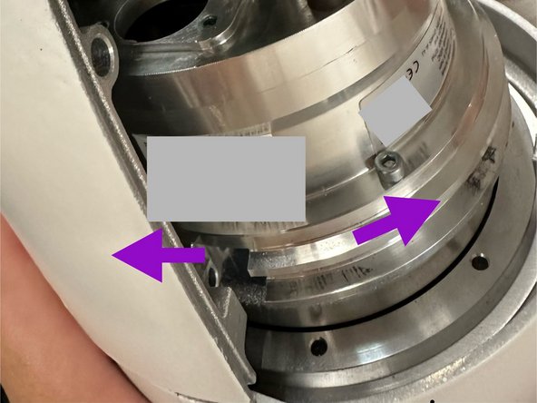

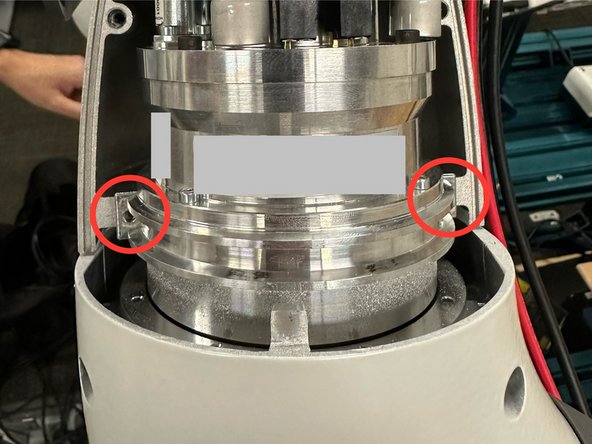

  3. Franka Emika Panda Robot Electromagnetic Locking System (Brake) Replacement, Remove the fairing screw boss block: crwdns2935265:03crwdnd2935265:01crwdnd2935265:03crwdne2935265:0 Franka Emika Panda Robot Electromagnetic Locking System (Brake) Replacement, Remove the fairing screw boss block: crwdns2935265:03crwdnd2935265:02crwdnd2935265:03crwdne2935265:0 Franka Emika Panda Robot Electromagnetic Locking System (Brake) Replacement, Remove the fairing screw boss block: crwdns2935265:03crwdnd2935265:03crwdnd2935265:03crwdne2935265:0
    • Power off the robot and disconnect the cable to the Franka Control Box.
    • Gently move the robot arm in the direction of the green arrow while supporting the weight of the arm.
    • Notice the gap on the fairings (blue circle) once the arm has been moved.
    • The screw boss blocks (red circle) are present on both sides of the robot. Tap on them lightly to remove.
    • After removing the screw boss blocks, the actuator assembly and everything downstream of the broken joint should be free to rotate along the purple arrows.
    • The actuator is still locked and does not contribute to the rotation.

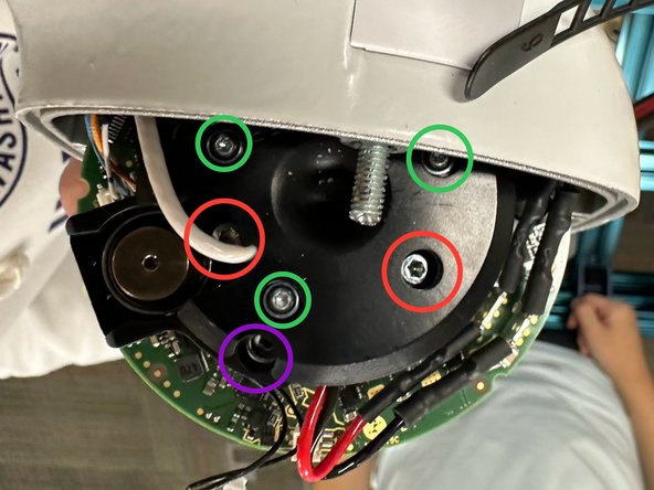

  4. Franka Emika Panda Robot Electromagnetic Locking System (Brake) Replacement, Loosen the black plastic cap: crwdns2935265:04crwdnd2935265:01crwdnd2935265:03crwdne2935265:0 Franka Emika Panda Robot Electromagnetic Locking System (Brake) Replacement, Loosen the black plastic cap: crwdns2935265:04crwdnd2935265:02crwdnd2935265:03crwdne2935265:0 Franka Emika Panda Robot Electromagnetic Locking System (Brake) Replacement, Loosen the black plastic cap: crwdns2935265:04crwdnd2935265:03crwdnd2935265:03crwdne2935265:0
    • Remove the 3 screws circled in red, which holds the black cap onto the actuator assembly.
    • The design of the black cap may vary slightly depend on the robot joint. Here J5 is pictured.
    • The screws circled in purple do not need to be removed.
    • The screws circled in green do not need to be removed.
    • Once the screws are removed, the black cap can be lifted up slightly, as illustrated by the red arrow. There is no need to remove the black cap.

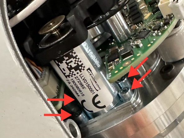

  5. Franka Emika Panda Robot Electromagnetic Locking System (Brake) Replacement, Unfasten the broken locking solenoid: crwdns2935265:05crwdnd2935265:01crwdnd2935265:03crwdne2935265:0 Franka Emika Panda Robot Electromagnetic Locking System (Brake) Replacement, Unfasten the broken locking solenoid: crwdns2935265:05crwdnd2935265:02crwdnd2935265:03crwdne2935265:0 Franka Emika Panda Robot Electromagnetic Locking System (Brake) Replacement, Unfasten the broken locking solenoid: crwdns2935265:05crwdnd2935265:03crwdnd2935265:03crwdne2935265:0
    • Disconnect the 2-pin connector (in red box) connecting the locking solenoid to the main PCB.
    • Remove the 4 M2 screws (red arrows) that fasten the locking solenoid.
    • The locations of the screws may be obstructed by the robot fairing, PCB, and the black cap.
    • Rotate the robot (see step 3) and shift the black cap around (see step 4) to gain access to the screws.
    • Be careful not to damage any cables or protruding electronics.

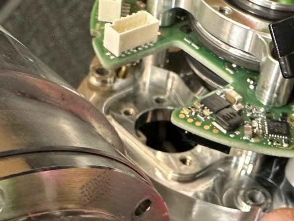

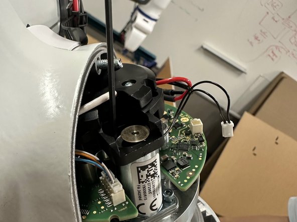

  6. Franka Emika Panda Robot Electromagnetic Locking System (Brake) Replacement, Remove the broken locking solenoid: crwdns2935265:06crwdnd2935265:01crwdnd2935265:02crwdne2935265:0 Franka Emika Panda Robot Electromagnetic Locking System (Brake) Replacement, Remove the broken locking solenoid: crwdns2935265:06crwdnd2935265:02crwdnd2935265:02crwdne2935265:0
    • Lift the black cap slightly as illustrated by the red arrow.
    • The cap needs to be lifted so it doesn't block the locking solenoid on its way out.
    • Extract the broken locking solenoid.
    • Some light wiggling and prying with a spudger at the mounting interface could be helpful.
    • Insert the new locking solenoid and follow the steps in reverse to reassemble the robot.
    • The locking solenoid can be actuated once the two pin connector is plugged in. In case the replacement has not been confirmed to work.
Once the robot has been reassembled, connect the control box and perform unlock to verify the repair. You have now fixed your robot!
