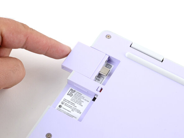

  1. Framework Laptop 12 Expansion Card Installation, Install the Expansion Cards: crwdns2935265:01crwdnd2935265:01crwdnd2935265:03crwdne2935265:0 Framework Laptop 12 Expansion Card Installation, Install the Expansion Cards: crwdns2935265:01crwdnd2935265:02crwdnd2935265:03crwdne2935265:0 Framework Laptop 12 Expansion Card Installation, Install the Expansion Cards: crwdns2935265:01crwdnd2935265:03crwdnd2935265:03crwdne2935265:0
    • Slide each Expansion Card into its Expansion Card slot.
  2. Framework Laptop 12 Expansion Card Installation, Lock the Expansion Card slots: crwdns2935265:02crwdnd2935265:01crwdnd2935265:02crwdne2935265:0 Framework Laptop 12 Expansion Card Installation, Lock the Expansion Card slots: crwdns2935265:02crwdnd2935265:02crwdnd2935265:02crwdne2935265:0
    • If there's a red bar showing under either Expansion Card latch, use your finger to flip the latch and lock the Expansion Card into its slot.
    • Locking the Expansion Card slots helps keep the cards in place when you unplug cables from them.
