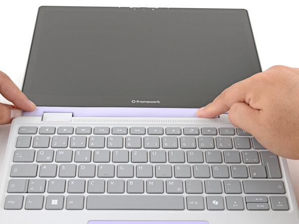

  1. Framework Laptop 12 Display Cover Installation, Install the Display Cover: crwdns2935265:01crwdnd2935265:01crwdnd2935265:02crwdne2935265:0 Framework Laptop 12 Display Cover Installation, Install the Display Cover: crwdns2935265:01crwdnd2935265:02crwdnd2935265:02crwdne2935265:0
    • Align the Display Cover to the bottom of the display.
  2. Framework Laptop 12 Display Cover Installation: crwdns2935265:02crwdnd2935265:01crwdnd2935265:02crwdne2935265:0 Framework Laptop 12 Display Cover Installation: crwdns2935265:02crwdnd2935265:02crwdnd2935265:02crwdne2935265:0
    • Use your finger to press along the length of the Display Cover to snap it onto the laptop.
    • Make sure all the clips along the left, top, and right edges are fully seated.
If you need help, contact Framework support.
