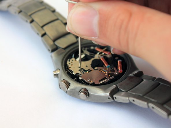

    • Keep clasp in open position.
    • Push one of the spring-loaded pins out of the hole with a Push-pin.
    • Wiggle watch band and clasp till free from each other.
  2. Fossil Speedway Watch TI-5061 Time Setting Dial Replacement, Back: crwdns2935265:02crwdnd2935265:01crwdnd2935265:01crwdne2935265:0
    • Fit the blades of a pair of scissors into the grooves of the screw back.
    • Twist the screw back counter clockwise with the scissors.
    • Once the back is loose enough, you can use your fingers to twist it off.
  3. Fossil Speedway Watch TI-5061 Time Setting Dial Replacement, Time Setting Dial: crwdns2935265:03crwdnd2935265:01crwdnd2935265:02crwdne2935265:0 Fossil Speedway Watch TI-5061 Time Setting Dial Replacement, Time Setting Dial: crwdns2935265:03crwdnd2935265:02crwdnd2935265:02crwdne2935265:0
    • Press the release button for the Time Setting Dial using a thin pin.
  4. Fossil Speedway Watch TI-5061 Time Setting Dial Replacement: crwdns2935265:04crwdnd2935265:01crwdnd2935265:02crwdne2935265:0 Fossil Speedway Watch TI-5061 Time Setting Dial Replacement: crwdns2935265:04crwdnd2935265:02crwdnd2935265:02crwdne2935265:0
    • Pull the dial out gently with fingers.
