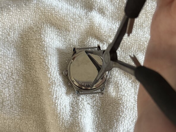

  1. Fossil FS-4494 Battery Replacement, Battery: crwdns2935265:01crwdnd2935265:01crwdnd2935265:01crwdne2935265:0
    • Before you begin, remove the watch band.
    • Flip the Fossil FS-4494 watch backside up.

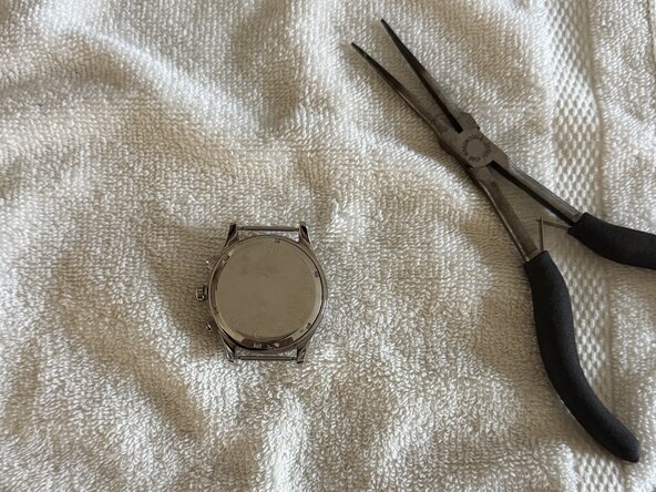

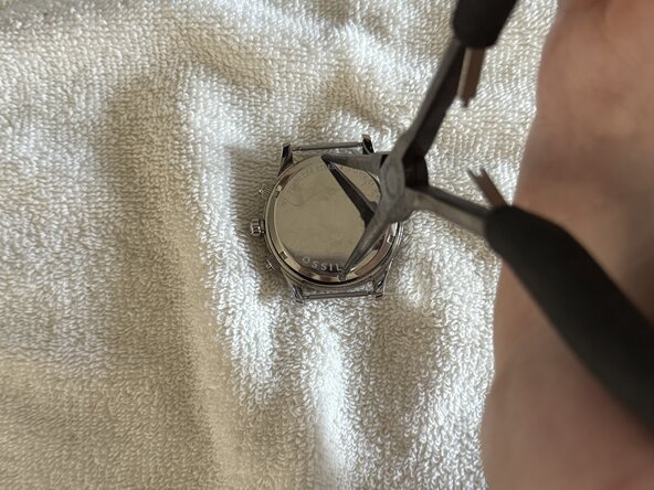

  2. Fossil FS-4494 Battery Replacement: crwdns2935265:02crwdnd2935265:01crwdnd2935265:01crwdne2935265:0
    • Be extremely careful when you apply pressure with the pliers, because the watch's backside cover is slippery.
    • There are multiple indentations for you to place the needle-nose pliers into.
    • The back of the watch will release with a pop sound when unlocked.
    • With one hand hold the watch face on the front, and with the other hand use the needle nose pliers (or a watch back removal tool) to grip the backside cover and twist the backside cover counterclockwise to unlock it.

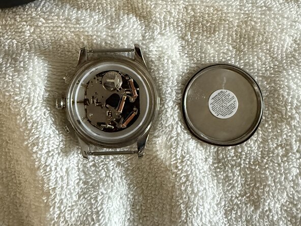

  3. Fossil FS-4494 Battery Replacement: crwdns2935265:03crwdnd2935265:01crwdnd2935265:01crwdne2935265:0
    • Be extremely careful when removing the backside cover as each piece inside the watch is delicate and can be easily broken.
    • Remove the backside watch cover from the watch

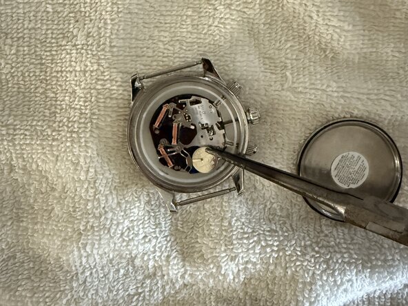

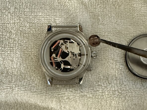

  4. Fossil FS-4494 Battery Replacement: crwdns2935265:04crwdnd2935265:01crwdnd2935265:01crwdne2935265:0
    • When you remove the battery, do not shift the other components inside the watch around. Shifting the other components inside the watch can damage the components and the watch itself.
    • Remember how and where you pulled out the watch's battery, as that will be the identical process when you place a new battery back into the watch.
    • Turn the watch so it is easy to access to the watch's battery.
    • With your needle nose pliers, carefully grab the battery from the watch.
    • Pull the battery out of the watch.

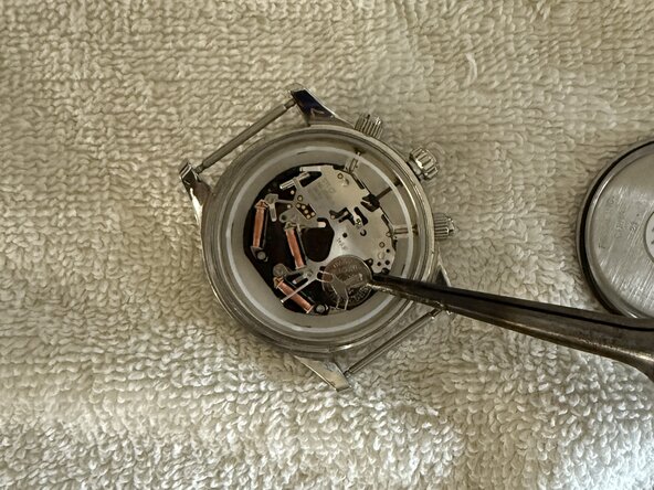

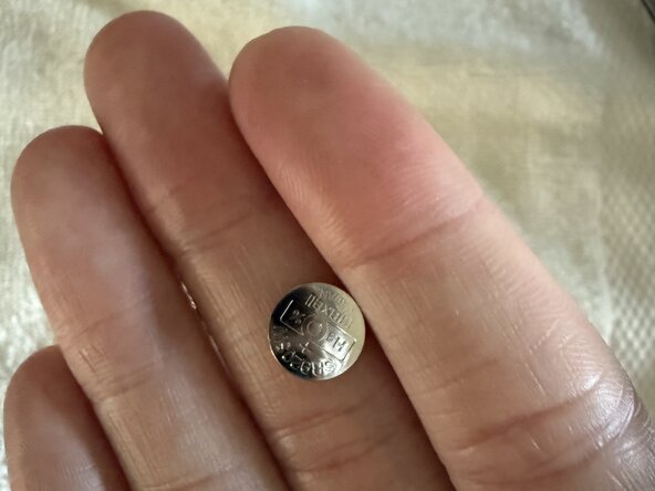

  5. Fossil FS-4494 Battery Replacement: crwdns2935265:05crwdnd2935265:01crwdnd2935265:01crwdne2935265:0
    • Do not throw the battery away because you need an identical battery to replace it in your watch. Save the old battery so that you can check if the new battery matches the original battery.
    • As seen in the picture on the left, we have a small circle battery from the watch.
  6. Fossil FS-4494 Battery Replacement: crwdns2935265:06crwdnd2935265:01crwdnd2935265:01crwdne2935265:0
    • Do not buy the wrong battery for your watch as using the wrong battery can cause damage to the watch.
    • Make sure to buy the exact same model of the battery when shopping in your local hardware store or from an online retailer.
    • Look closely at the battery, you will see writing on the surface of the battery. This writing will give the model code for the battery.
    • Check the model code for the new battery before installing the battery inside the watch. If the model code for the new battery does not match the model code for the original battery, you must purchase another battery which has the correct model code.

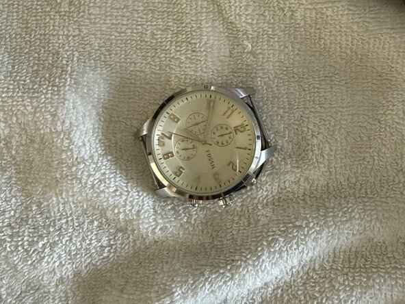

  9. Fossil FS-4494 Battery Replacement: crwdns2935265:09crwdnd2935265:01crwdnd2935265:01crwdne2935265:0
    • Make sure the watch is working and then set up your watch to your time zone.
    • CONGRATULATIONS, you have successfully replaced a Fossil FS-4494 watch's battery.
