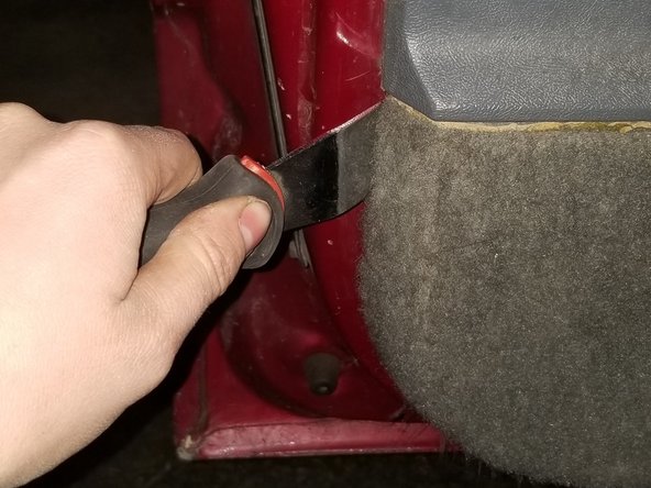

    • Remove door panel by using a flat head screw driver or a paint scraper to slide between the body of the door and the inside of the door panel to lift up on the 6-10 push pins
    • Be careful to not lift up hard without your tool being next to the push pin otherwise it may break.

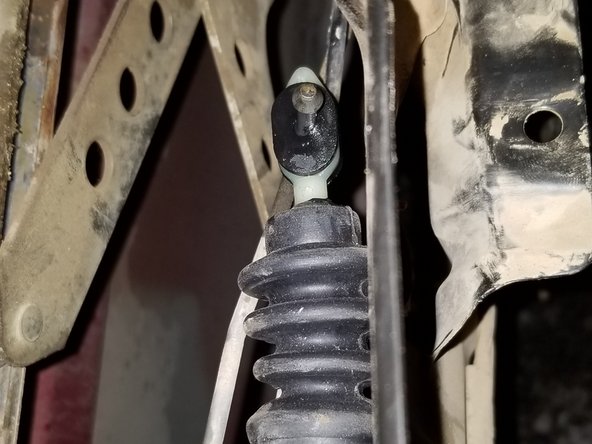

  4. For Almost Every Vehicle Door Lock Actuator Replacement: crwdns2935265:04crwdnd2935265:01crwdnd2935265:03crwdne2935265:0 For Almost Every Vehicle Door Lock Actuator Replacement: crwdns2935265:04crwdnd2935265:02crwdnd2935265:03crwdne2935265:0 For Almost Every Vehicle Door Lock Actuator Replacement: crwdns2935265:04crwdnd2935265:03crwdnd2935265:03crwdne2935265:0
    • After locating the door lock actuator, which will be on the top or bottom of the door furthest from the engine bay, unplug the single socket running to it by depressing the tab and pulling it away from the motor.
    • As shown in the third image there is an eye hole where your door lock rod will be running through. This will need to be pulled out from the actuator as well

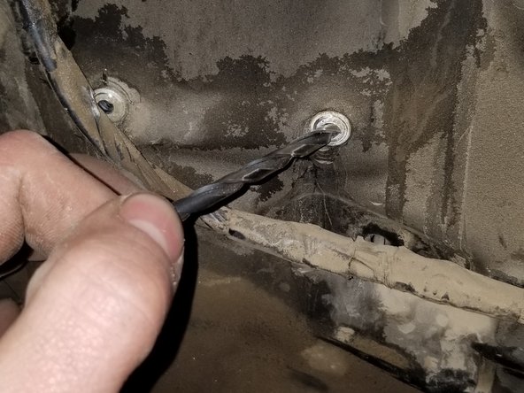

  5. For Almost Every Vehicle Door Lock Actuator Replacement: crwdns2935265:05crwdnd2935265:01crwdnd2935265:03crwdne2935265:0 For Almost Every Vehicle Door Lock Actuator Replacement: crwdns2935265:05crwdnd2935265:02crwdnd2935265:03crwdne2935265:0 For Almost Every Vehicle Door Lock Actuator Replacement: crwdns2935265:05crwdnd2935265:03crwdnd2935265:03crwdne2935265:0
    • Using a drill with some drill bits to remove the rivets from the door body by finding a bit size that is bigger than the size of the dimple in the head. This may need more than one round of drilling so do not be afraid to incrementally go up in bit size.
    • After drilling this out there will be an eyelet on the end of your drill and hear a ting of the back half falling to the ground this means you have dismounted the actuator

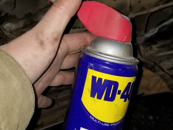

  6. For Almost Every Vehicle Door Lock Actuator Replacement: crwdns2935265:06crwdnd2935265:01crwdnd2935265:03crwdne2935265:0 For Almost Every Vehicle Door Lock Actuator Replacement: crwdns2935265:06crwdnd2935265:02crwdnd2935265:03crwdne2935265:0 For Almost Every Vehicle Door Lock Actuator Replacement: crwdns2935265:06crwdnd2935265:03crwdnd2935265:03crwdne2935265:0
    • After the actuator is removed from the door the new one must be unboxed and prepped for install
    • Use WD-40 to spray down the eyelet (the rubber ring) as shown to make the pressing of the rod back into the loop easier, it is a very tight fit
