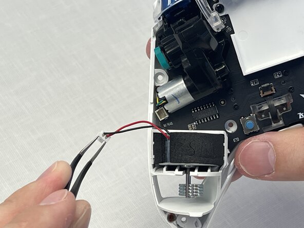

  10. Flydigi Apex 5 USB-C Daughterboard Replacement, Vibration Motors: crwdns2935265:010crwdnd2935265:01crwdnd2935265:03crwdne2935265:0 Flydigi Apex 5 USB-C Daughterboard Replacement, Vibration Motors: crwdns2935265:010crwdnd2935265:02crwdnd2935265:03crwdne2935265:0 Flydigi Apex 5 USB-C Daughterboard Replacement, Vibration Motors: crwdns2935265:010crwdnd2935265:03crwdnd2935265:03crwdne2935265:0
    • Press a prong of each side of the angled tweezers under the lip of the motor's power supply connector and pull the plastic connector out of its terminal.
    • Lift the motor directly upward out of its casing.

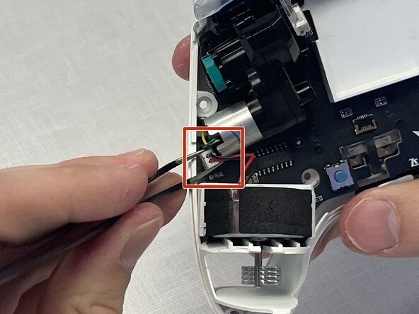

  11. Flydigi Apex 5 USB-C Daughterboard Replacement: crwdns2935265:011crwdnd2935265:01crwdnd2935265:03crwdne2935265:0 Flydigi Apex 5 USB-C Daughterboard Replacement: crwdns2935265:011crwdnd2935265:02crwdnd2935265:03crwdne2935265:0 Flydigi Apex 5 USB-C Daughterboard Replacement: crwdns2935265:011crwdnd2935265:03crwdnd2935265:03crwdne2935265:0
    • Press a prong of each side of the curved tip tweezers under the lip of the motor's power supply connector and pull the plastic connector out of its terminal.

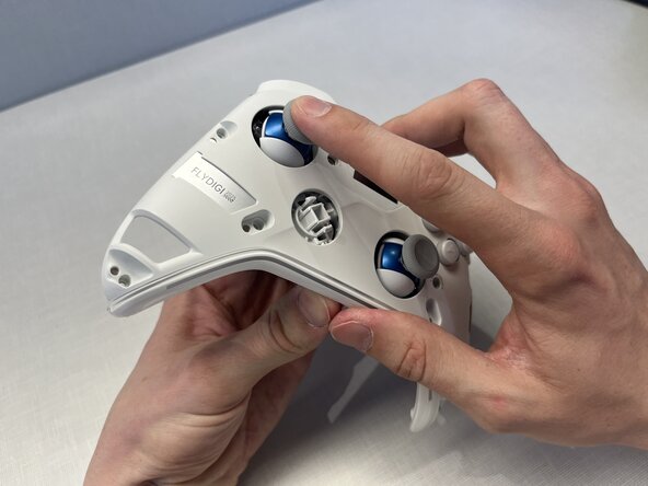

  12. Flydigi Apex 5 USB-C Daughterboard Replacement, USB-C Daughterboard: crwdns2935265:012crwdnd2935265:01crwdnd2935265:02crwdne2935265:0 Flydigi Apex 5 USB-C Daughterboard Replacement, USB-C Daughterboard: crwdns2935265:012crwdnd2935265:02crwdnd2935265:02crwdne2935265:0
    • Remove the USB-C faceplate by inserting the spudger as shown, pushing the spudger forward while twisting slightly.

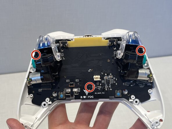

    • Remove the four 5mm screws using a Phillips #00 screwdriver.
    • Remove the two vibration motor housings by pulling away from the controller.
  15. Flydigi Apex 5 USB-C Daughterboard Replacement: crwdns2935265:015crwdnd2935265:01crwdnd2935265:03crwdne2935265:0 Flydigi Apex 5 USB-C Daughterboard Replacement: crwdns2935265:015crwdnd2935265:02crwdnd2935265:03crwdne2935265:0 Flydigi Apex 5 USB-C Daughterboard Replacement: crwdns2935265:015crwdnd2935265:03crwdnd2935265:03crwdne2935265:0
    • Remove the three 10mm screws using a Phillips #1 screwdriver.
    • Use your index finger to push on the left joystick, while also pulling on the motherboard with your other hand.

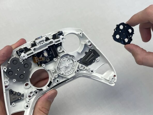

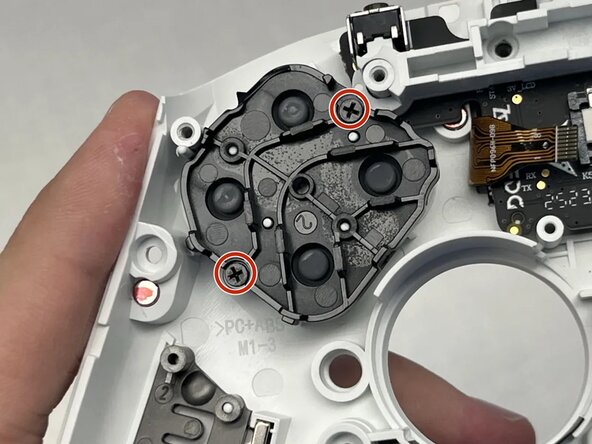

    • Use a Phillips #0 screwdriver to remove the two 5mm screws connecting the D-pad to the front of the controller.
    • Remove the black plastic cover holding the D-pad to the front of the controller.

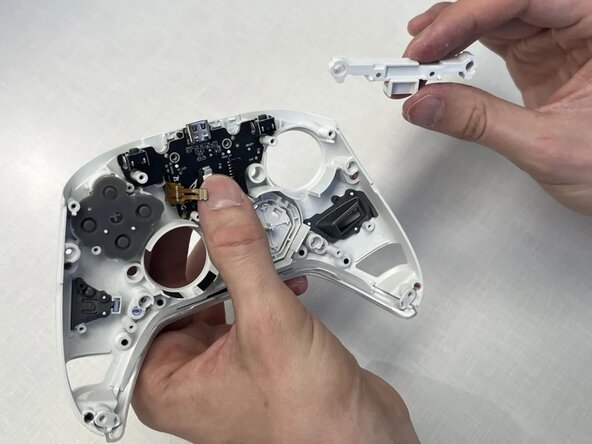

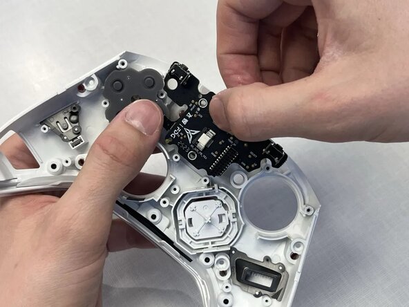

    • Use a Phillips #0 screwdriver to remove the two 7mm screws.
    • Remove the plastic bridge covering the USB-C daughterbord.
    • Pull the USB-C daughterboard away from the front of the controller.
