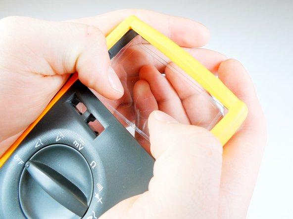

  4. Fluke 77 Series III LCD Screen Cover Replacement, LCD Screen Cover: crwdns2935265:04crwdnd2935265:01crwdnd2935265:02crwdne2935265:0 Fluke 77 Series III LCD Screen Cover Replacement, LCD Screen Cover: crwdns2935265:04crwdnd2935265:02crwdnd2935265:02crwdne2935265:0
    • Hold the front panel with both hands.
    • Use your thumbs to firmly, but carefully push the LCD screen cover out and into your fingers on the other side of the front panel.
