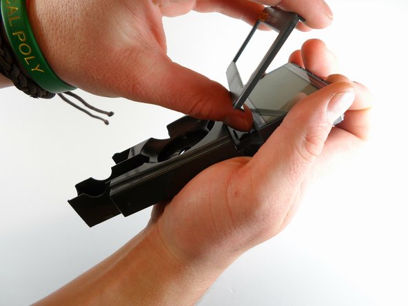

  14. Fluke 77 Series III LCD Replacement, LCD: crwdns2935265:014crwdnd2935265:01crwdnd2935265:02crwdne2935265:0 Fluke 77 Series III LCD Replacement, LCD: crwdns2935265:014crwdnd2935265:02crwdnd2935265:02crwdne2935265:0
    • Turn the internal cover over with both hands.
    • Pry off the LCD screen bracket bordering the display.
