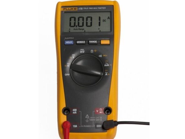

    • Turn off meter and disconnect test leads.
    • Warning: To prevent possible electrical shock, fire, personal injury, or damage to the product:
    • Remove the test leads and any input signals before replacing the fuse.
    • Use ONLY fuses with the amperage, interrupt, voltage, and speed ratings specified.
    • Replace the battery as soon as the low battery indicator appears.

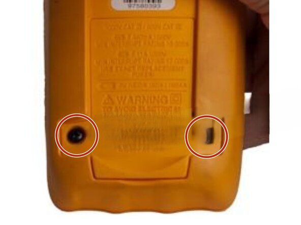

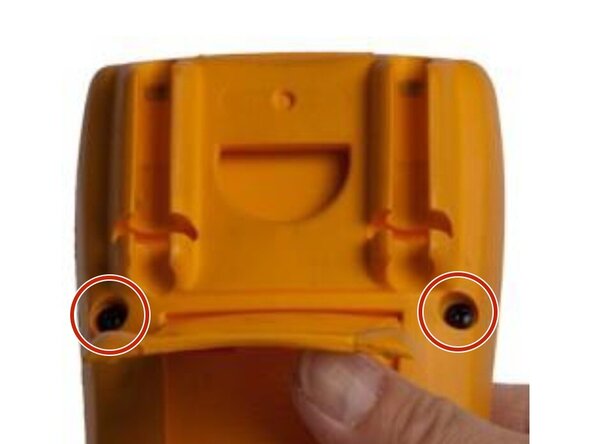

  2. Fluke 175 Multimeter Fuse Replacement, Back Cover Removal: crwdns2935265:02crwdnd2935265:01crwdnd2935265:02crwdne2935265:0 Fluke 175 Multimeter Fuse Replacement, Back Cover Removal: crwdns2935265:02crwdnd2935265:02crwdnd2935265:02crwdne2935265:0
    • Use a Phillips PH1 driver.
    • Remove the 2 bottom screws by turning counterclockwise.
    • Remove the 2 top screws.

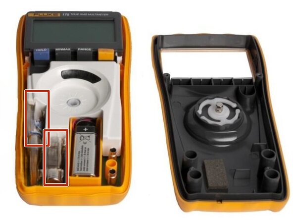

  3. Fluke 175 Multimeter Fuse Replacement, Remove Back Panel: crwdns2935265:03crwdnd2935265:01crwdnd2935265:01crwdne2935265:0
    • Carefully remove the front panel from the back section.
    • Do not move control knob while device is open.

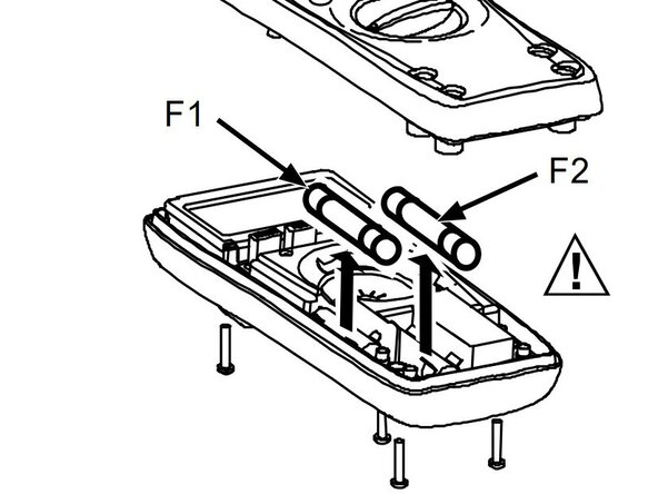

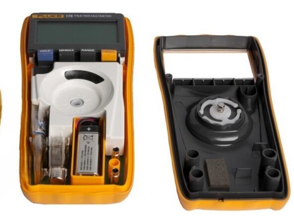

  4. Fluke 175 Multimeter Fuse Replacement, Remove Fuses: crwdns2935265:04crwdnd2935265:01crwdnd2935265:02crwdne2935265:0 Fluke 175 Multimeter Fuse Replacement, Remove Fuses: crwdns2935265:04crwdnd2935265:02crwdnd2935265:02crwdne2935265:0
    • Remove and replace fuses.
    • F1 Fuse, 440 mA, 1000 V, FAST
    • F2 Fuse, 11 A, 1000V, FAST
