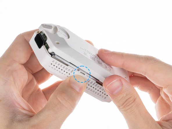

  4. Flipper Zero Teardown, Open the back cover: crwdns2935265:04crwdnd2935265:01crwdnd2935265:03crwdne2935265:0 Flipper Zero Teardown, Open the back cover: crwdns2935265:04crwdnd2935265:02crwdnd2935265:03crwdne2935265:0 Flipper Zero Teardown, Open the back cover: crwdns2935265:04crwdnd2935265:03crwdnd2935265:03crwdne2935265:0
    • Press the middle of the top cover on both sides, one by one, to release the latches that hold the back cover in place.
    • Once the latches are released, you can remove the bottom cover.

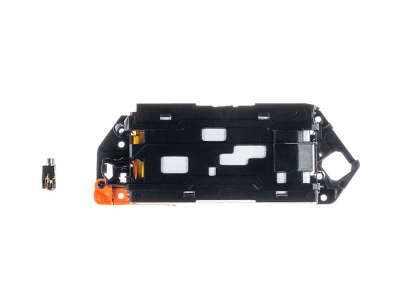

  19. Flipper Zero Teardown, Remove the vibration motor: crwdns2935265:019crwdnd2935265:01crwdnd2935265:02crwdne2935265:0 Flipper Zero Teardown, Remove the vibration motor: crwdns2935265:019crwdnd2935265:02crwdnd2935265:02crwdne2935265:0
    • Take out the vibration motor.
