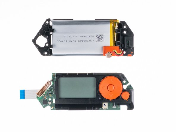

  5. Flipper Zero Button Replacement, Disconnect the battery: crwdns2935265:06crwdnd2935265:01crwdnd2935265:01crwdne2935265:0
    Spudger
    $3.99
    • Disconnect the battery by carefully prying the connector with a Spudger and pulling it out.

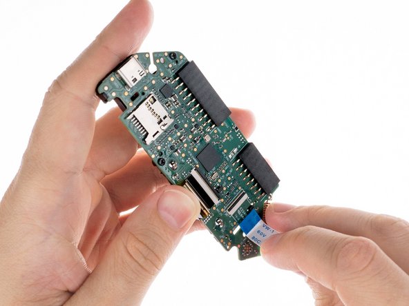

  6. Flipper Zero Button Replacement, Disconnect the ribbon cable: crwdns2935265:07crwdnd2935265:01crwdnd2935265:01crwdne2935265:0
    iFixit Opening Picks (Set of 6)
    $4.95
    • Disconnect the large ribbon cable from the board. Use a plastic pick to lift the latch up to open the lock and carefully pull it out of the connector.
  7. Flipper Zero Button Replacement, Release the battery chassis: crwdns2935265:08crwdnd2935265:01crwdnd2935265:02crwdne2935265:0 Flipper Zero Button Replacement, Release the battery chassis: crwdns2935265:08crwdnd2935265:02crwdnd2935265:02crwdne2935265:0
    • To release the battery chassis, lightly rock it back and forth while pulling the two parts apart.
    • Be sure to apply gentle and consistent pressure to avoid damaging the device.
  8. Flipper Zero Button Replacement, Remove the ribbon cable: crwdns2935265:09crwdnd2935265:01crwdnd2935265:02crwdne2935265:0 Flipper Zero Button Replacement, Remove the ribbon cable: crwdns2935265:09crwdnd2935265:02crwdnd2935265:02crwdne2935265:0
    $4.95
    • Use a plastic pick to lift the latch up to unlock the connector and carefully remove the ribbon cable.

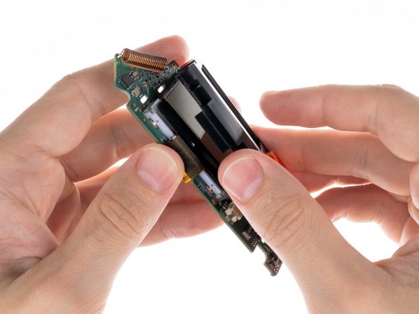

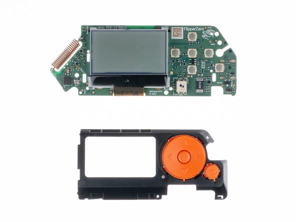

  9. Flipper Zero Button Replacement, Unscrew the the button chassis: crwdns2935265:010crwdnd2935265:01crwdnd2935265:01crwdne2935265:0
    Phillips #0 Screwdriver
    $5.49
    • Unscrew the two short screws holding the button chassis using a PH0 screwdriver.
  10. Flipper Zero Button Replacement, Seperate the button chassis: crwdns2935265:011crwdnd2935265:01crwdnd2935265:03crwdne2935265:0 Flipper Zero Button Replacement, Seperate the button chassis: crwdns2935265:011crwdnd2935265:02crwdnd2935265:03crwdne2935265:0 Flipper Zero Button Replacement, Seperate the button chassis: crwdns2935265:011crwdnd2935265:03crwdnd2935265:03crwdne2935265:0
    • To seperate the button chassis and the board, press the latch on the side shown below and pull the chassis away from the board.

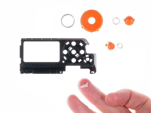

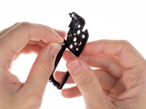

  11. Flipper Zero Button Replacement, The button layout: crwdns2935265:012crwdnd2935265:01crwdnd2935265:01crwdne2935265:0
    • To remove the buttons you need to release the latches.
    • OK
    • D-pad
    • Back
    • The central button (OK) is removed after the navigation button (D-pad).
  12. Flipper Zero Button Replacement, Unlatching the buttons: crwdns2935265:013crwdnd2935265:01crwdnd2935265:01crwdne2935265:0
    Flathead 1.5 mm Screwdriver
    $1.99
  13. Flipper Zero Button Replacement, Remove the light diffuser: crwdns2935265:014crwdnd2935265:01crwdnd2935265:03crwdne2935265:0 Flipper Zero Button Replacement, Remove the light diffuser: crwdns2935265:014crwdnd2935265:02crwdnd2935265:03crwdne2935265:0 Flipper Zero Button Replacement, Remove the light diffuser: crwdns2935265:014crwdnd2935265:03crwdnd2935265:03crwdne2935265:0
    • Use a flat head screwdriver to release the light diffuser from the chassis and pull it out.
