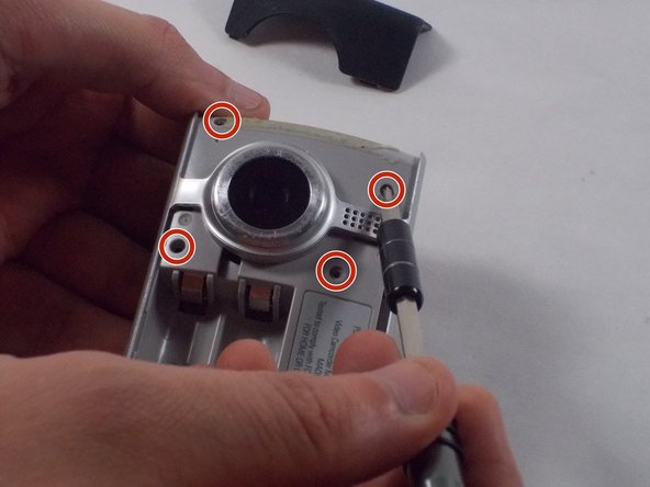

  5. Flip Video Ultra USB connector Replacement: crwdns2935265:05crwdnd2935265:01crwdnd2935265:02crwdne2935265:0 Flip Video Ultra USB connector Replacement: crwdns2935265:05crwdnd2935265:02crwdnd2935265:02crwdne2935265:0
    • Remove the six 1mm screws from front of the camera with the Phillips Head screwdriver.

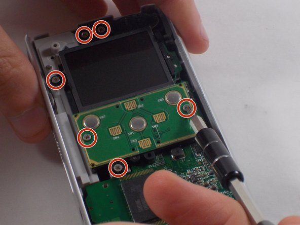

  7. Flip Video Ultra USB connector Replacement: crwdns2935265:07crwdnd2935265:01crwdnd2935265:02crwdne2935265:0 Flip Video Ultra USB connector Replacement: crwdns2935265:07crwdnd2935265:02crwdnd2935265:02crwdne2935265:0
    • When removing the back panel, the rubber buttons will become loose and likely fall off the board. This is normal and can easily placed back on the board once finished.
    • Remove the six 1mm screws with the 1 Phillips head screwdriver.

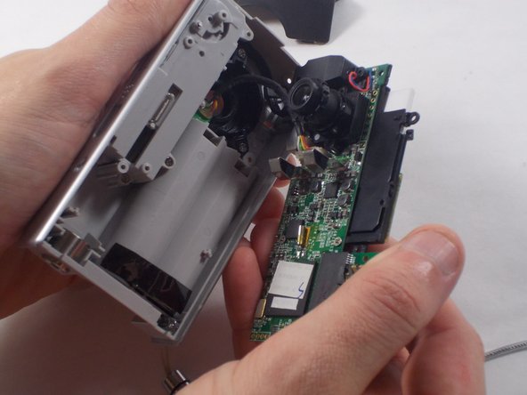

  8. Flip Video Ultra USB connector Replacement: crwdns2935265:08crwdnd2935265:01crwdnd2935265:02crwdne2935265:0 Flip Video Ultra USB connector Replacement: crwdns2935265:08crwdnd2935265:02crwdnd2935265:02crwdne2935265:0
    • Gently separate the circuit board from the casing.

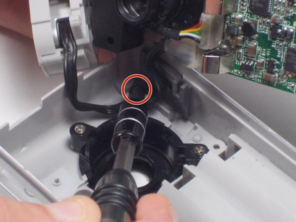

  9. Flip Video Ultra USB connector Replacement: crwdns2935265:09crwdnd2935265:01crwdnd2935265:02crwdne2935265:0 Flip Video Ultra USB connector Replacement: crwdns2935265:09crwdnd2935265:02crwdnd2935265:02crwdne2935265:0
    • Remove the three 1mm screws from the USB connector and back casing with the Phillips Head screwdriver.

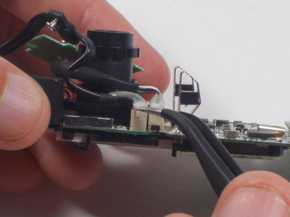

  10. Flip Video Ultra USB connector Replacement: crwdns2935265:010crwdnd2935265:01crwdnd2935265:02crwdne2935265:0 Flip Video Ultra USB connector Replacement: crwdns2935265:010crwdnd2935265:02crwdnd2935265:02crwdne2935265:0
    • Gently lift the usb connector using the Plastic opening tool.
    • Using tweezers, remove the cord from the motherboard by gently lifting the connector.
    • The connector will be easier to remove if you wiggle the tweezers while lifting.
  11. Flip Video Ultra USB connector Replacement: crwdns2935265:011crwdnd2935265:01crwdnd2935265:01crwdne2935265:0
    • Fully remove the USB connector and replace it with the new USB connector.
