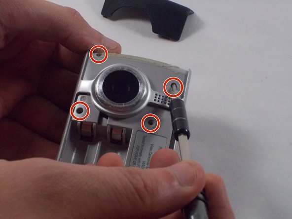

    5. Flip Video Ultra USB Spring Replacement: crwdns2935265:05crwdnd2935265:01crwdnd2935265:02crwdne2935265:0 Flip Video Ultra USB Spring Replacement: crwdns2935265:05crwdnd2935265:02crwdnd2935265:02crwdne2935265:0
      • Remove the six 1mm screws from the back and upper casing with the Phillips Head screwdriver.

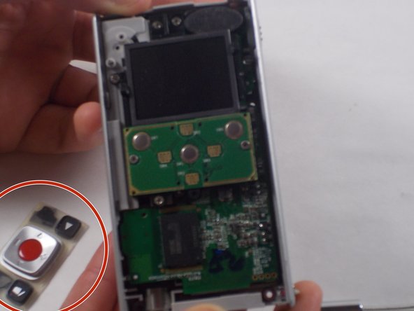

    7. Flip Video Ultra USB Spring Replacement: crwdns2935265:07crwdnd2935265:01crwdnd2935265:02crwdne2935265:0 Flip Video Ultra USB Spring Replacement: crwdns2935265:07crwdnd2935265:02crwdnd2935265:02crwdne2935265:0
      • When removing the back panel, the rubber buttons will become loose and likely fall off the board. This is normal and can easily placed back on the board once finished.
      • Remove the six 1mm screws with the 1 Phillips head screwdriver.
    8. Flip Video Ultra USB Spring Replacement: crwdns2935265:08crwdnd2935265:01crwdnd2935265:01crwdne2935265:0
      • Gently separate the circuit board from the casing.
