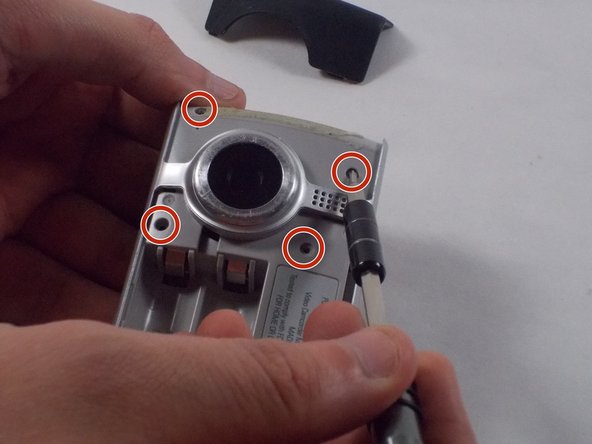

  5. Flip Video Ultra Power button Replacement: crwdns2935265:05crwdnd2935265:01crwdnd2935265:02crwdne2935265:0 Flip Video Ultra Power button Replacement: crwdns2935265:05crwdnd2935265:02crwdnd2935265:02crwdne2935265:0
    • Remove the six 1mm screws from the back and upper casing with the Phillips Head screwdriver.

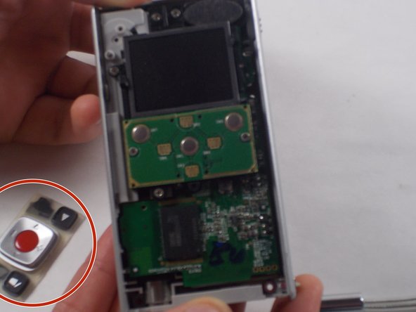

  6. Flip Video Ultra Power button Replacement: crwdns2935265:06crwdnd2935265:01crwdnd2935265:01crwdne2935265:0
    • Remove the top casing from the bottom to reveal the inner circuit board.
  7. Flip Video Ultra Power button Replacement: crwdns2935265:07crwdnd2935265:01crwdnd2935265:02crwdne2935265:0 Flip Video Ultra Power button Replacement: crwdns2935265:07crwdnd2935265:02crwdnd2935265:02crwdne2935265:0
    • When removing the back panel, the rubber buttons will become loose and likely fall off the board. This is normal and can easily placed back on the board once finished.
    • Remove the six 1mm screws with the 1 Phillips head screwdriver.

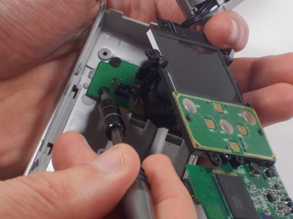

  8. Flip Video Ultra Power button Replacement: crwdns2935265:08crwdnd2935265:01crwdnd2935265:01crwdne2935265:0
    • Gently separate the circuit board from the casing.

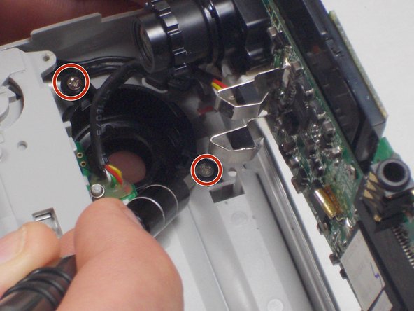

  10. Flip Video Ultra Power button Replacement: crwdns2935265:010crwdnd2935265:01crwdnd2935265:02crwdne2935265:0 Flip Video Ultra Power button Replacement: crwdns2935265:010crwdnd2935265:02crwdnd2935265:02crwdne2935265:0
    • Unscrew the 2 1mm screws and gently separate camera wires from plastic casing.

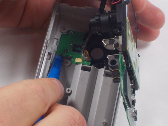

  11. Flip Video Ultra Power button Replacement: crwdns2935265:011crwdnd2935265:01crwdnd2935265:01crwdne2935265:0
    • Gently pry out the USB housing unit with the Ifxit Opening Tool.

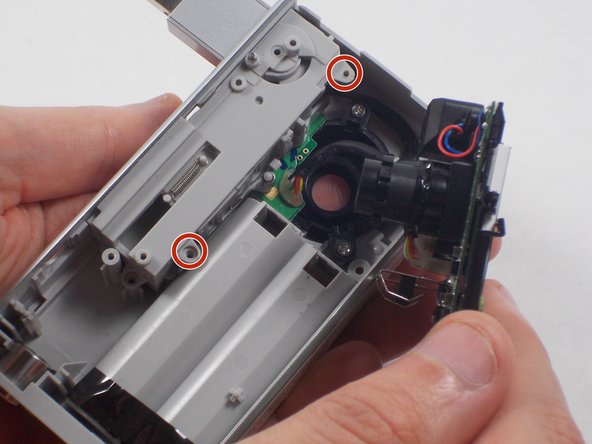

  12. Flip Video Ultra Power button Replacement: crwdns2935265:012crwdnd2935265:01crwdnd2935265:03crwdne2935265:0 Flip Video Ultra Power button Replacement: crwdns2935265:012crwdnd2935265:02crwdnd2935265:03crwdne2935265:0 Flip Video Ultra Power button Replacement: crwdns2935265:012crwdnd2935265:03crwdnd2935265:03crwdne2935265:0
    • Remove the two 1mm screws and separate the circuit board and camera from the plastic casing.
  13. Flip Video Ultra Power button Replacement: crwdns2935265:013crwdnd2935265:01crwdnd2935265:01crwdne2935265:0
    • Unscrew the camera housing unit from the plastic case.
