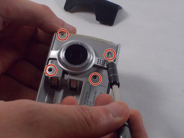

    • Remove the six 1mm screws from the back and upper casing with the Phillips Head screwdriver.

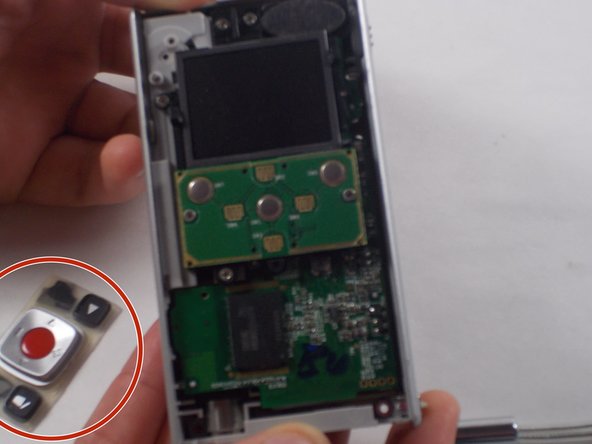

    • Remove the top casing from the bottom to reveal the inner circuit board.
  7. Flip Video Ultra Circuit Board Replacement: crwdns2935265:07crwdnd2935265:01crwdnd2935265:02crwdne2935265:0 Flip Video Ultra Circuit Board Replacement: crwdns2935265:07crwdnd2935265:02crwdnd2935265:02crwdne2935265:0

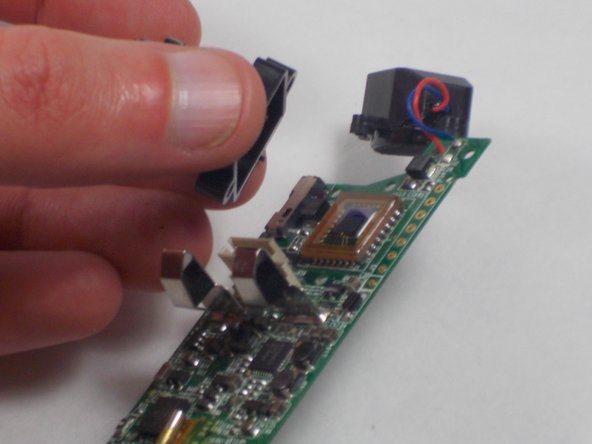

    • When removing the back panel, the rubber buttons will become loose and likely fall off the board. This is normal and can easily placed back on the board once finished.
    • Remove the six 1mm screws with the 1 Phillips head screwdriver.

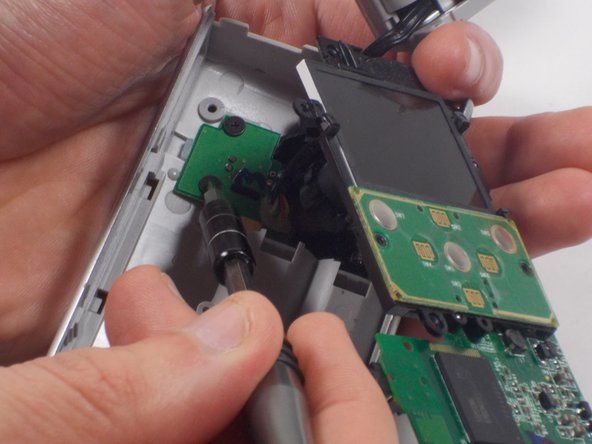

    • Unscrew the single 1mm screw from USB housing unit.

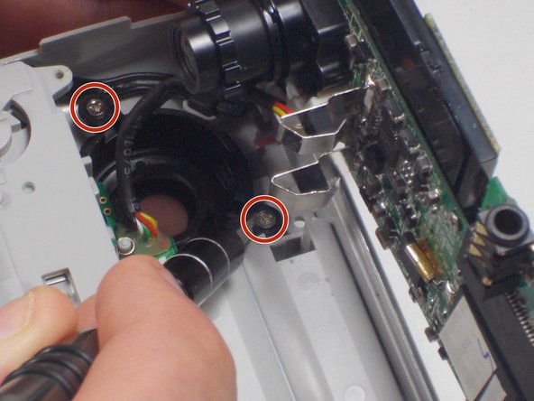

  10. Flip Video Ultra Circuit Board Replacement: crwdns2935265:010crwdnd2935265:01crwdnd2935265:02crwdne2935265:0 Flip Video Ultra Circuit Board Replacement: crwdns2935265:010crwdnd2935265:02crwdnd2935265:02crwdne2935265:0
    • Unscrew the 2 1mm screws and gently separate camera wires from plastic casing.

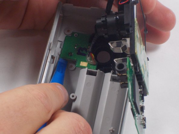

    • Gently pry out the USB housing unit with the Ifxit Opening Tool.

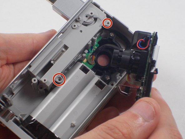

  12. Flip Video Ultra Circuit Board Replacement: crwdns2935265:012crwdnd2935265:01crwdnd2935265:03crwdne2935265:0 Flip Video Ultra Circuit Board Replacement: crwdns2935265:012crwdnd2935265:02crwdnd2935265:03crwdne2935265:0 Flip Video Ultra Circuit Board Replacement: crwdns2935265:012crwdnd2935265:03crwdnd2935265:03crwdne2935265:0

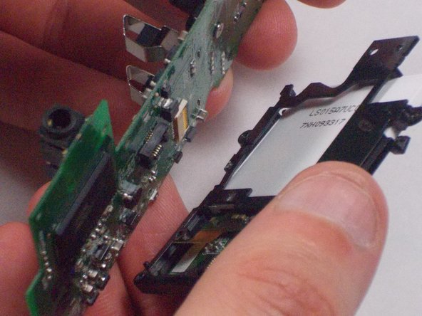

    • Remove the two 1mm screws and separate the circuit board and camera from the plastic casing.

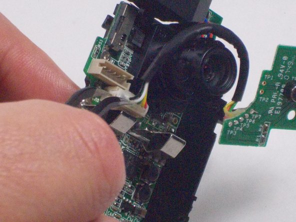

  14. Flip Video Ultra Circuit Board Replacement: crwdns2935265:014crwdnd2935265:01crwdnd2935265:03crwdne2935265:0 Flip Video Ultra Circuit Board Replacement: crwdns2935265:014crwdnd2935265:02crwdnd2935265:03crwdne2935265:0 Flip Video Ultra Circuit Board Replacement: crwdns2935265:014crwdnd2935265:03crwdnd2935265:03crwdne2935265:0

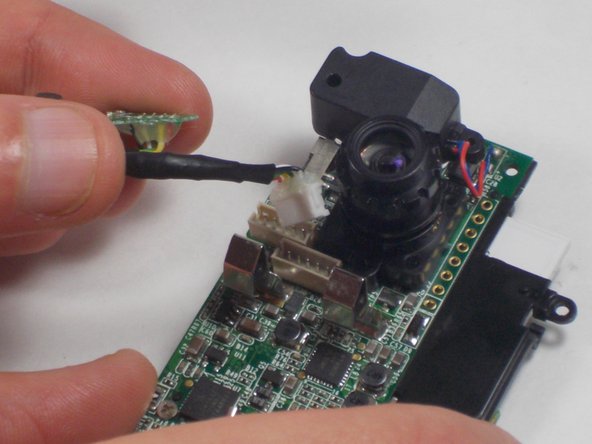

    • With tweezers, remove the microphone and USB connections.
