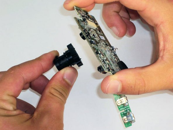

  13. Flip Video Lens Replacement, Lens: crwdns2935265:013crwdnd2935265:01crwdnd2935265:02crwdne2935265:0 Flip Video Lens Replacement, Lens: crwdns2935265:013crwdnd2935265:02crwdnd2935265:02crwdne2935265:0
    • Flip over circuit board so the ribbon connector is facing up.
    • Remove the 2 stainless steel 3mm screws securing the lens to circuit board with the #00 Phillips screwdriver.
    • The lens can now be removed and replaced.
