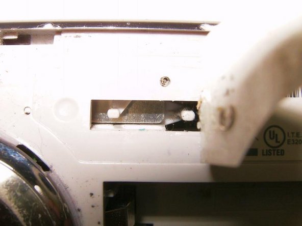

      • Here is the Flip Ultra HD and it shows lots of use.
      • The USB latch does not return to the upright position when the USB arm is retracted.
      • Slide the battery latch to unlock
    2. Flip Ultra HD USB Latch Spring Replacement: crwdns2935265:02crwdnd2935265:01crwdnd2935265:03crwdne2935265:0 Flip Ultra HD USB Latch Spring Replacement: crwdns2935265:02crwdnd2935265:02crwdnd2935265:03crwdne2935265:0 Flip Ultra HD USB Latch Spring Replacement: crwdns2935265:02crwdnd2935265:03crwdnd2935265:03crwdne2935265:0
      • Slide the front panel down and up to remove.
      • Remove the battery by pulling up on the tab
      • Peel the identification sticker back about half way.
    3. Flip Ultra HD USB Latch Spring Replacement: crwdns2935265:03crwdnd2935265:01crwdnd2935265:02crwdne2935265:0 Flip Ultra HD USB Latch Spring Replacement: crwdns2935265:03crwdnd2935265:02crwdnd2935265:02crwdne2935265:0
      • Beneath the sticker is a rectangular opening that houses the spring for the USB latch return. In this case it is clearly broken
      • Use a pair of Needle Nose Pliers to remove and replace the spring
