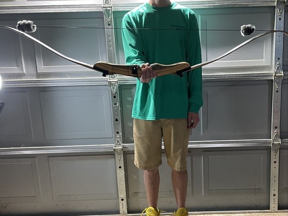

    • Remove the broken or damaged bow string.
  2. Fleetwood Monarch 62" Recurve Bow String Replacement: crwdns2935265:02crwdnd2935265:01crwdnd2935265:01crwdne2935265:0
    • One end of the new bowstring will have a loop with a larger diameter than the other. Take the larger loop and secure it onto one end of the bow.
  3. Fleetwood Monarch 62" Recurve Bow String Replacement: crwdns2935265:03crwdnd2935265:01crwdnd2935265:01crwdne2935265:0
    • Slide the larger loop halfway down the limb of the bow.
  4. Fleetwood Monarch 62" Recurve Bow String Replacement: crwdns2935265:04crwdnd2935265:01crwdnd2935265:01crwdne2935265:0
    • Secure the smaller loop onto the other end of the bow.

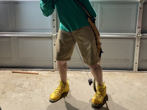

  5. Fleetwood Monarch 62" Recurve Bow String Replacement: crwdns2935265:05crwdnd2935265:01crwdnd2935265:03crwdne2935265:0 Fleetwood Monarch 62" Recurve Bow String Replacement: crwdns2935265:05crwdnd2935265:02crwdnd2935265:03crwdne2935265:0 Fleetwood Monarch 62" Recurve Bow String Replacement: crwdns2935265:05crwdnd2935265:03crwdnd2935265:03crwdne2935265:0
    • Place your left leg between the bow shaft and the bow string.
    • Place your foot behind the end of the bow touching the ground.
    • Place one hand near the middle of the bow and the other hand on the string, close to the larger loop.
    • Push down on the top end of the bow and slide the larger loop into place.
