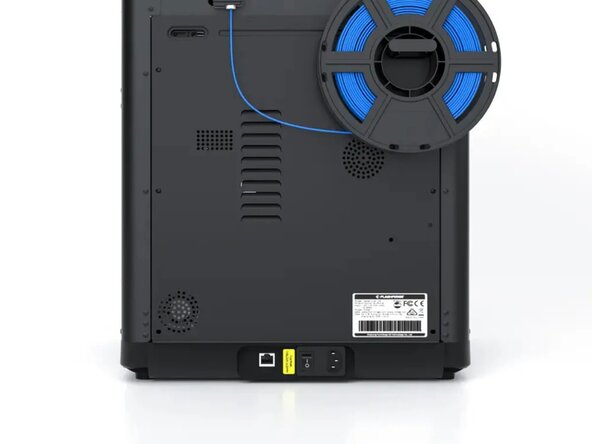

    • First, turn the printer off by flipping the switch located in the back of the printer to the OFF position.

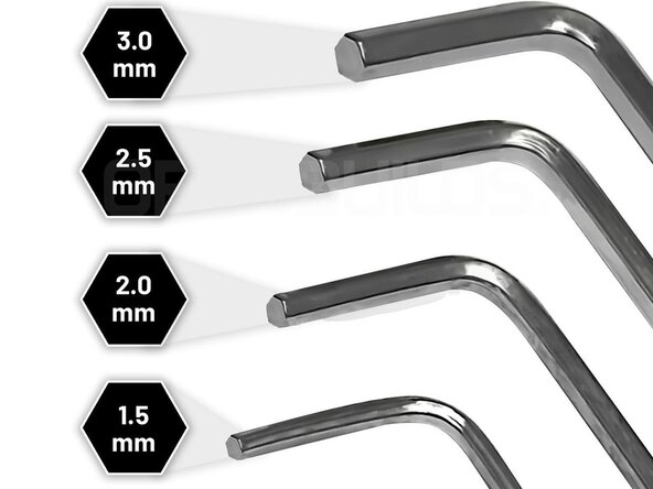

  2. Flashforge Nozzle Unclogging, Unscrewing the extruder: crwdns2935265:02crwdnd2935265:01crwdnd2935265:01crwdne2935265:0
    • Get the smallest Allen Key that is included with the package, then unscrew it until the head of the screw is sitting above the assembly

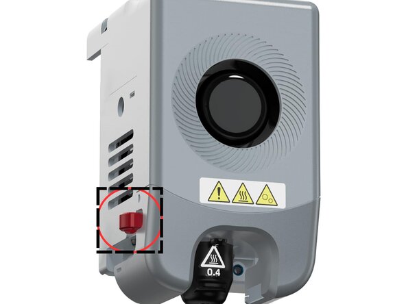

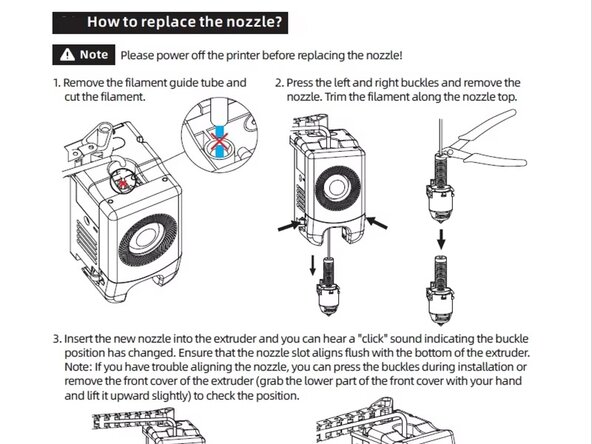

  3. Flashforge Nozzle Unclogging, Taking out the nozzle: crwdns2935265:03crwdnd2935265:01crwdnd2935265:02crwdne2935265:0 Flashforge Nozzle Unclogging, Taking out the nozzle: crwdns2935265:03crwdnd2935265:02crwdnd2935265:02crwdne2935265:0
    • Press and hold the red latches that are on both sides, then you must gently pull the nozzle out while wiggling it a bit. The nozzle should come out.

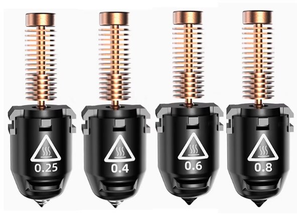

  4. Flashforge Nozzle Unclogging, Taking out the clog: crwdns2935265:04crwdnd2935265:01crwdnd2935265:01crwdne2935265:0
    • With the nozzle out, cut or pull any filament sticking up from the top.

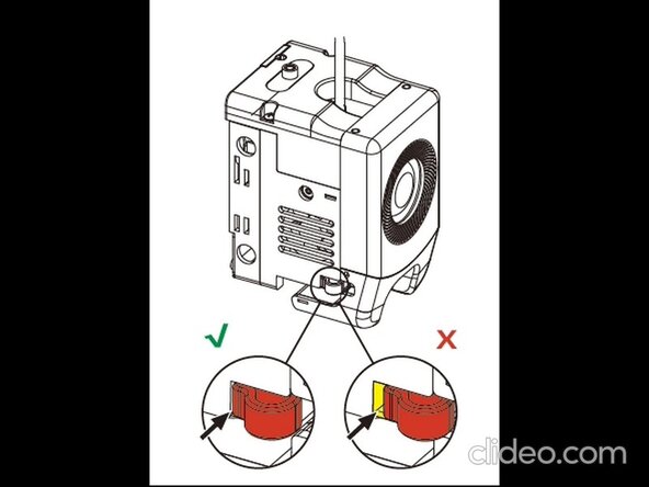

  5. Flashforge Nozzle Unclogging, Putting the nozzle back in: crwdns2935265:05crwdnd2935265:01crwdnd2935265:01crwdne2935265:0
    • After that, push the nozzle back in with the pins facing the back and the nozzle sign facing you. Push it in gently until it clicks.
  6. Flashforge Nozzle Unclogging, Tightening the screw: crwdns2935265:06crwdnd2935265:01crwdnd2935265:01crwdne2935265:0
    • With the same Allen Key, Screw the key in until it is flush with the assembly.
  7. Flashforge Nozzle Unclogging, Turning the printer back on: crwdns2935265:07crwdnd2935265:01crwdnd2935265:01crwdne2935265:0
    • With the switch located at the back, flip it to the On position. If the light shows up at the screen, Your printer is not done for and is in an OK position. If it does not post, you will have to take it to a repair shop.
