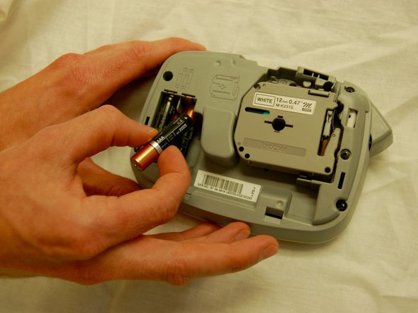

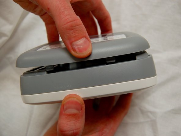

    • Turn your label-maker on its face. Using your thumb, press in and then upward on the fastener located on the side of your device.
  2. Fixing a Jammed Paper-Roll in your Brother PT-90 Personal Labeler: crwdns2935265:02crwdnd2935265:01crwdnd2935265:03crwdne2935265:0 Fixing a Jammed Paper-Roll in your Brother PT-90 Personal Labeler: crwdns2935265:02crwdnd2935265:02crwdnd2935265:03crwdne2935265:0 Fixing a Jammed Paper-Roll in your Brother PT-90 Personal Labeler: crwdns2935265:02crwdnd2935265:03crwdnd2935265:03crwdne2935265:0
    • Remove the batteries from your device.

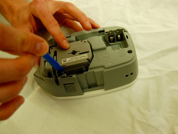

    • Using a plastic opening tool from your iFixit tool kit, leverage the label cartridge out of your device.

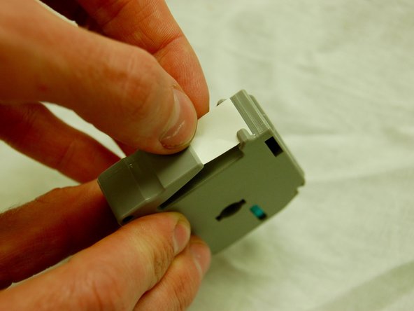

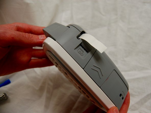

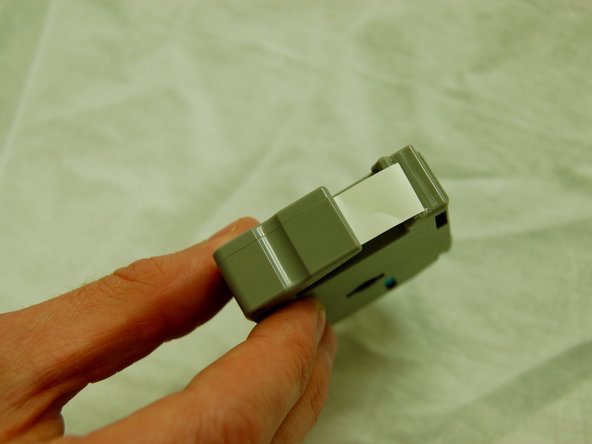

    • Press the label paper back into alignment with the small holders on the right side of the label cartridge.

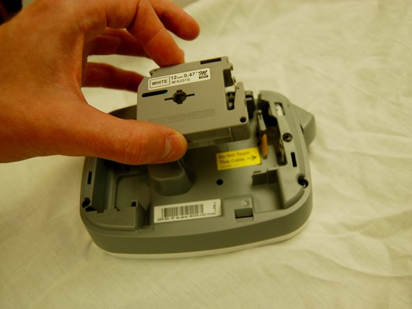

    • Place the label cartridge and batteries back into your device. Refasten the bottom case of the label-maker.

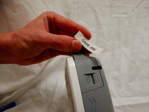

    • Well done! You have successfully corrected the paper-jam in your Brother PT-90 Label-Maker.
