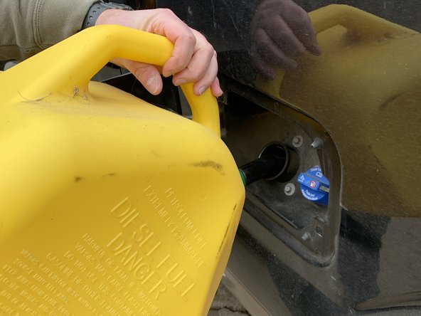

  2. Fixing Gelled Diesel in a 2008 Ford F-250: crwdns2935265:02crwdnd2935265:01crwdnd2935265:03crwdne2935265:0 Fixing Gelled Diesel in a 2008 Ford F-250: crwdns2935265:02crwdnd2935265:02crwdnd2935265:03crwdne2935265:0 Fixing Gelled Diesel in a 2008 Ford F-250: crwdns2935265:02crwdnd2935265:03crwdnd2935265:03crwdne2935265:0
    • Be sure to follow all of the instructions printed on your Gelled Diesel Additive.
    • Pour 16 ounces of Gelled Diesel Additive to every 20 gallons of fuel directly into the tank using the funnel as shown.
  3. Fixing Gelled Diesel in a 2008 Ford F-250: crwdns2935265:03crwdnd2935265:01crwdnd2935265:02crwdne2935265:0 Fixing Gelled Diesel in a 2008 Ford F-250: crwdns2935265:03crwdnd2935265:02crwdnd2935265:02crwdne2935265:0
    • Pour a quarter of a tank worth of diesel into the tank.
    • More diesel in the tank gives you a greater chance of the truck starting in the freezing weather.

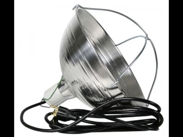

  6. Fixing Gelled Diesel in a 2008 Ford F-250: crwdns2935265:06crwdnd2935265:01crwdnd2935265:02crwdne2935265:0 Fixing Gelled Diesel in a 2008 Ford F-250: crwdns2935265:06crwdnd2935265:02crwdnd2935265:02crwdne2935265:0
    • Plug in your heat lamp and place the lamp under the truck, as this will also help heat the vehicle.
    • The heat lamp greatly increases the chance of the gelled diesel melting quicker.
