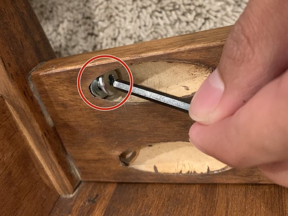

    • Grab your hex wrench and/or screwdriver.
    • Use the head for the screwdriver that best fits your screws/bolts and the same goes for the allen wrench.

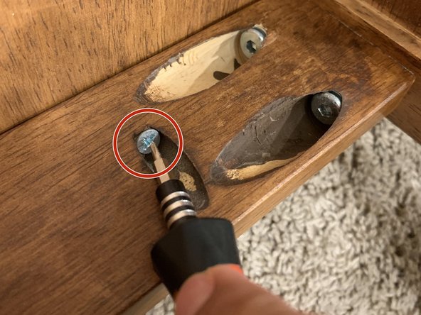

    • Using the hex wrench and/or screwdriver tighten any loose screws underneath the chair and check again for squeaking.
  4. Fixing  a chair that squeaks: crwdns2935265:04crwdnd2935265:01crwdnd2935265:03crwdne2935265:0 Fixing  a chair that squeaks: crwdns2935265:04crwdnd2935265:02crwdnd2935265:03crwdne2935265:0 Fixing  a chair that squeaks: crwdns2935265:04crwdnd2935265:03crwdnd2935265:03crwdne2935265:0
    • If the chair is still squeaking remove all screws from the leg(s) that is/are squeaking.
    • The dowel is now exposed.
    • Once you remove the screws you will be able to freely move the leg and any additional wood attached to it. Removing the additional wood will expose dowels, be sure to note where you removed the wood and position so you can correctly reassemble it later.

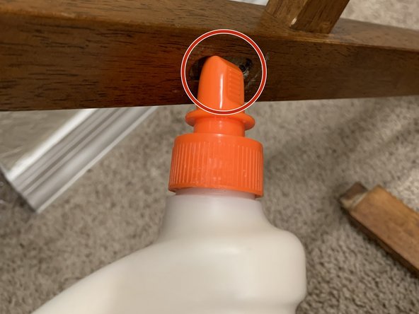

    • Apply the wood glue where the dowels are located, be sure to get the glue inside the holes.
    • Try to do this step as clean as you can, it can get very messy and wood glue can ruin wood.

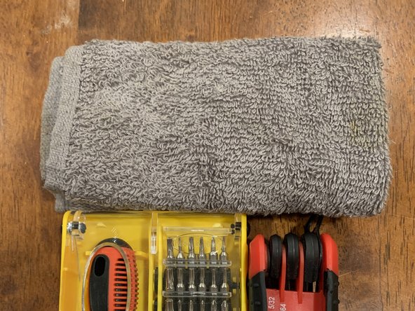

    • Once you’ve placed all wood back in their correct positions grab your hex wrench/screwdriver, and cloth.
    • Wet the cloth and and remove any excess glue from the chair.
    • DO NOT let the glue dry as it will ruin your wood.
    • Use the correct head size and allen wrench for your screws/bolts.

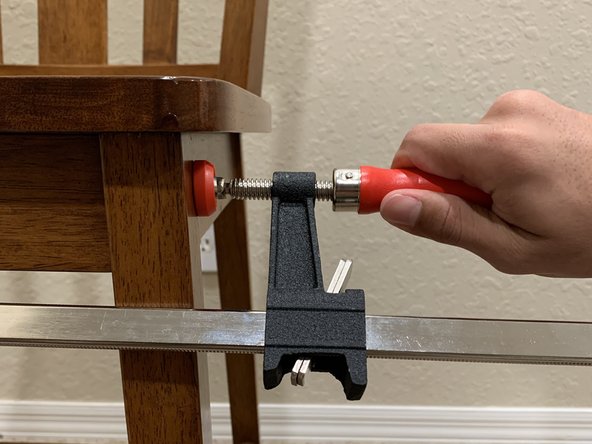

    • Grab your clamp(s) for the chair.
  11. Fixing  a chair that squeaks: crwdns2935265:011crwdnd2935265:01crwdnd2935265:03crwdne2935265:0 Fixing  a chair that squeaks: crwdns2935265:011crwdnd2935265:02crwdnd2935265:03crwdne2935265:0 Fixing  a chair that squeaks: crwdns2935265:011crwdnd2935265:03crwdnd2935265:03crwdne2935265:0
    • Secure the clamp(s) onto the chair and occasionally check for dripping glue.
    • Let the chair sit with clamp(s) on for a minimum of 24 hours.
    • DO NOT use the chair while clamps are attached and glue is wet, the glue will be misplaced and the chair will still squeak.
    • You have now completed the necessary steps to rid the terrible squeaks from your wooden chairs.
    • If you have more wooden chairs that squeak you will have to repeat this procedure.
