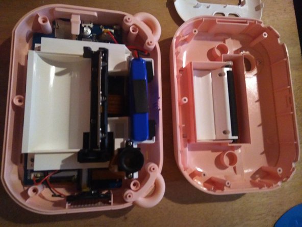

  3. Fix the MyFirst Camera Insta 2 charge issue, Unscrew front panel: crwdns2935265:03crwdnd2935265:01crwdnd2935265:02crwdne2935265:0 Fix the MyFirst Camera Insta 2 charge issue, Unscrew front panel: crwdns2935265:03crwdnd2935265:02crwdnd2935265:02crwdne2935265:0
    • The toy is closed by 5 Philips-head screws, size 0
    • Unscrew them all and open the product

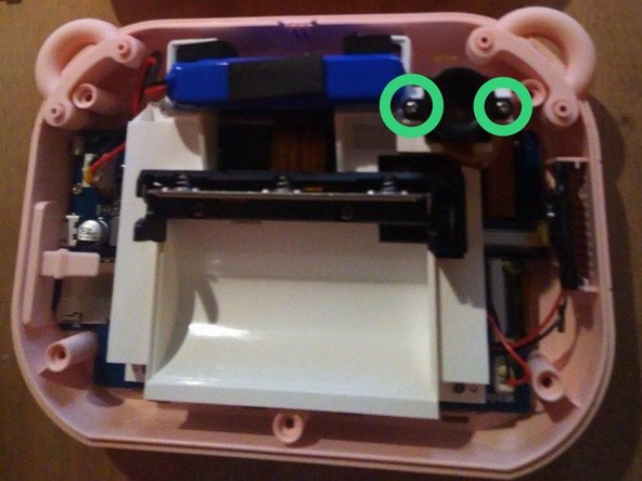

  4. Fix the MyFirst Camera Insta 2 charge issue, Remove the cartridge-holding piece: crwdns2935265:04crwdnd2935265:01crwdnd2935265:03crwdne2935265:0 Fix the MyFirst Camera Insta 2 charge issue, Remove the cartridge-holding piece: crwdns2935265:04crwdnd2935265:02crwdnd2935265:03crwdne2935265:0 Fix the MyFirst Camera Insta 2 charge issue, Remove the cartridge-holding piece: crwdns2935265:04crwdnd2935265:03crwdnd2935265:03crwdne2935265:0
    • The white piece is held by 4 Philips-head screws
    • Unscrew the three screws you can already access
    • Unscrew the selfie camera, held by two smaller screws

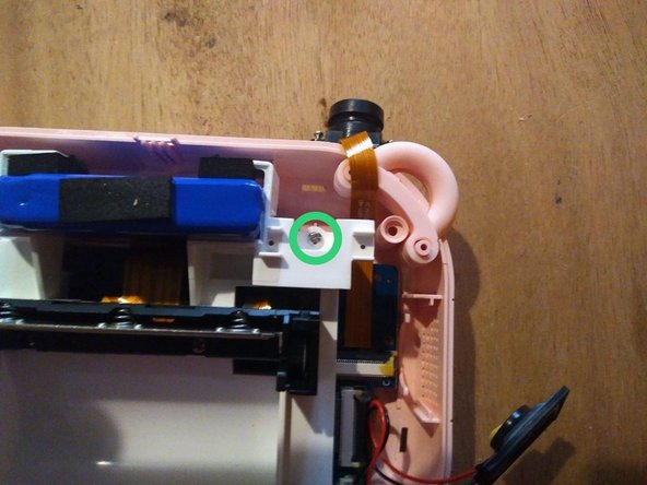

    • Under the camera, unscrew the forth screw holding the piece

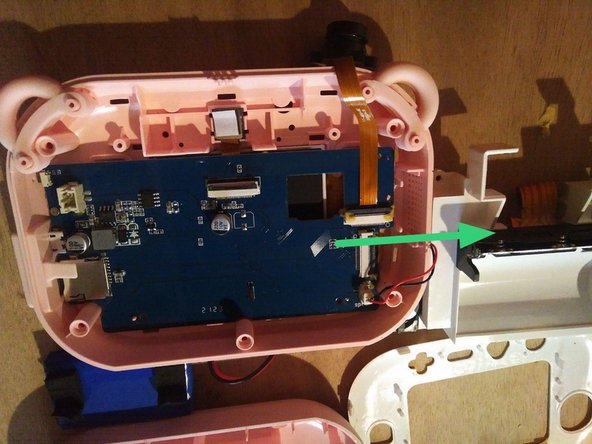

  5. Fix the MyFirst Camera Insta 2 charge issue, Disconnect the screen: crwdns2935265:05crwdnd2935265:01crwdnd2935265:01crwdne2935265:0
    • Remove the glue around the screen connector
    • Disconnect by lifting the connector clip upward
  6. Fix the MyFirst Camera Insta 2 charge issue, Unscrew the PCB: crwdns2935265:06crwdnd2935265:01crwdnd2935265:02crwdne2935265:0 Fix the MyFirst Camera Insta 2 charge issue, Unscrew the PCB: crwdns2935265:06crwdnd2935265:02crwdnd2935265:02crwdne2935265:0
    • The board is held by the 4 previously removed screws, plus another screw close to USB connector
    • Once all those are removed and the screen is disconnected, pull the card from its compartment by sliding it on the side opposite to USB connector

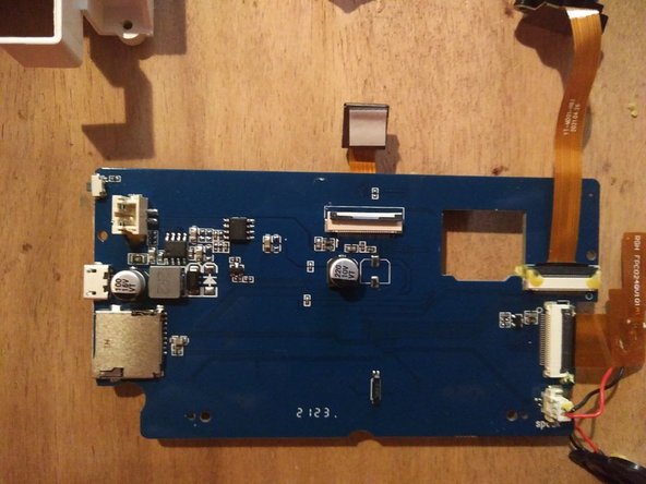

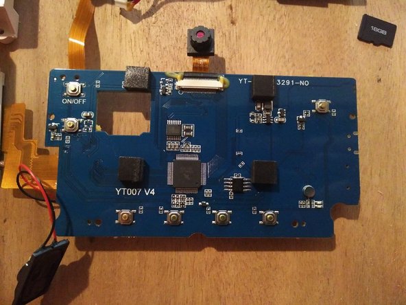

  7. Fix the MyFirst Camera Insta 2 charge issue, Teardown view: crwdns2935265:07crwdnd2935265:01crwdnd2935265:03crwdne2935265:0 Fix the MyFirst Camera Insta 2 charge issue, Teardown view: crwdns2935265:07crwdnd2935265:02crwdnd2935265:03crwdne2935265:0 Fix the MyFirst Camera Insta 2 charge issue, Teardown view: crwdns2935265:07crwdnd2935265:03crwdnd2935265:03crwdne2935265:0
    • Unknown microcontrolleur, QFP80 package , with reference "2104G-91"
    • Princeton Technology PT5139-HT motor driver
    • Syncrown PT48D 2-inch thermal printer
    • Thinksum 123050 7.4V 750mAh li-ion battery
    • Screen, speaker, two photo modules
