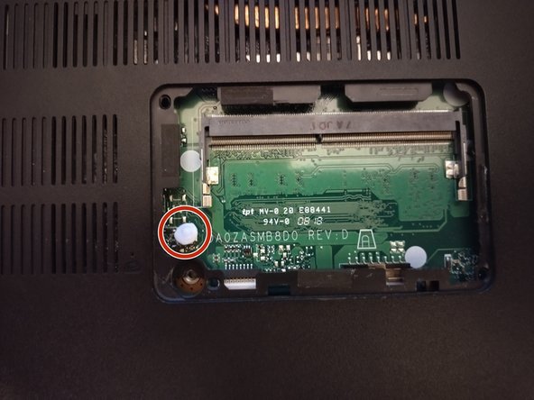

  3. Fix battery disabled/not recognised, Modify the Intrusion switch: crwdns2935265:03crwdnd2935265:01crwdnd2935265:02crwdne2935265:0 Fix battery disabled/not recognised, Modify the Intrusion switch: crwdns2935265:03crwdnd2935265:02crwdnd2935265:02crwdne2935265:0
    • Locate the chassis intrusion switch, at the bottom left of the exposed board section. You might want to put some blu-tack or very fine tape over it to help with pressing it down. Fortunately, this part of the board will not get too hot, so it shouldn't matter what you place there to press the switch into the ram slot cover.
To reassemble your device, press the RAM slot cover back onto the opening, sliding it in top first and then pressing down so it sits flush with the rest of the chassis. Then, screw it in with the singular mounting screw.
