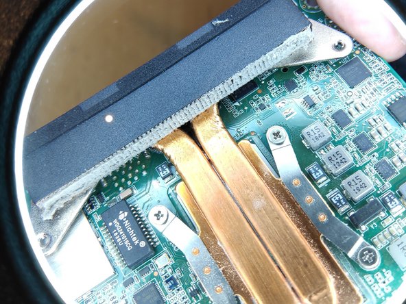

  9. Fix NUC8i7BEH overheating, Motherboard Removal, final step: crwdns2935265:012crwdnd2935265:01crwdnd2935265:03crwdne2935265:0 Fix NUC8i7BEH overheating, Motherboard Removal, final step: crwdns2935265:012crwdnd2935265:02crwdnd2935265:03crwdne2935265:0 Fix NUC8i7BEH overheating, Motherboard Removal, final step: crwdns2935265:012crwdnd2935265:03crwdnd2935265:03crwdne2935265:0
    • Use a pry tool to lift the motherboard from the casing
    • Marked with red circles the dust signs evident on first sight

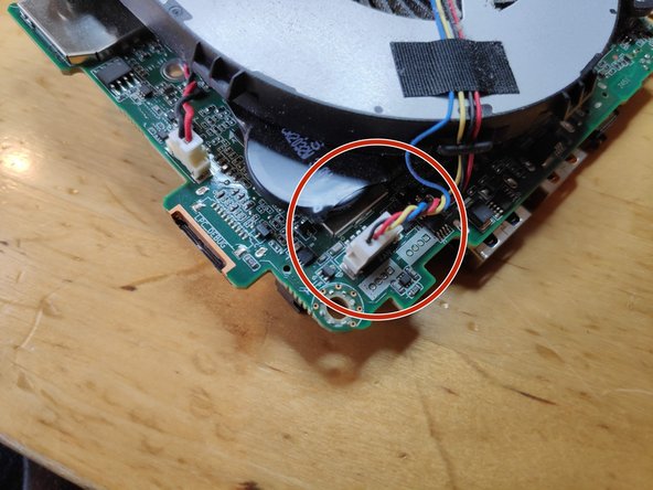

  10. Fix NUC8i7BEH overheating, Remove CPU fan: crwdns2935265:013crwdnd2935265:01crwdnd2935265:03crwdne2935265:0 Fix NUC8i7BEH overheating, Remove CPU fan: crwdns2935265:013crwdnd2935265:02crwdnd2935265:03crwdne2935265:0 Fix NUC8i7BEH overheating, Remove CPU fan: crwdns2935265:013crwdnd2935265:03crwdnd2935265:03crwdne2935265:0
    • Remove the 3 screws fixing the CPU fan
    • Remove the fan power connect from the motherboard

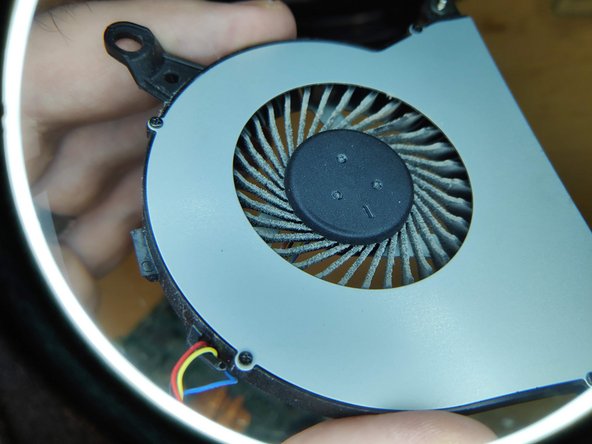

  11. Fix NUC8i7BEH overheating, Blast off dust from CPU air exit fins: crwdns2935265:014crwdnd2935265:01crwdnd2935265:03crwdne2935265:0 Fix NUC8i7BEH overheating, Blast off dust from CPU air exit fins: crwdns2935265:014crwdnd2935265:02crwdnd2935265:03crwdne2935265:0 Fix NUC8i7BEH overheating, Blast off dust from CPU air exit fins: crwdns2935265:014crwdnd2935265:03crwdnd2935265:03crwdne2935265:0
    • You will need to use compressed air, a small vacuum cleaner or something similar to blast off all the stucked dust.
  12. Fix NUC8i7BEH overheating, Blast off dust from CPU air exit fins, continued: crwdns2935265:015crwdnd2935265:01crwdnd2935265:01crwdne2935265:0
    • I'm using a compressed air can (optional)
    • Video of the procedure

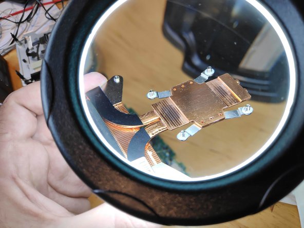

  13. Fix NUC8i7BEH overheating, Exchange thermal paste for CPU cooler (optional): crwdns2935265:018crwdnd2935265:01crwdnd2935265:02crwdne2935265:0 Fix NUC8i7BEH overheating, Exchange thermal paste for CPU cooler (optional): crwdns2935265:018crwdnd2935265:02crwdnd2935265:02crwdne2935265:0
    • This step is probably not necessary, but for the sake of completeness here it is.
    • Remove the screws holding the CPU cooler following the numbers on them.
  14. Fix NUC8i7BEH overheating, Clean old CPU thermal paste: crwdns2935265:019crwdnd2935265:01crwdnd2935265:03crwdne2935265:0 Fix NUC8i7BEH overheating, Clean old CPU thermal paste: crwdns2935265:019crwdnd2935265:02crwdnd2935265:03crwdne2935265:0 Fix NUC8i7BEH overheating, Clean old CPU thermal paste: crwdns2935265:019crwdnd2935265:03crwdnd2935265:03crwdne2935265:0
    • Use isopropyl alcohol for this, be careful not to touch the the thermal pads on the chips around the CPU.
  15. Fix NUC8i7BEH overheating, Reapply CPU thermal paste: crwdns2935265:020crwdnd2935265:01crwdnd2935265:01crwdne2935265:0
    • Be careful not to apply too much of it.
