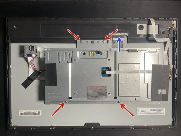

  3. Fix Dell U2415 Flickering Display, Remove control unit and clean panel connector: crwdns2935265:03crwdnd2935265:01crwdnd2935265:02crwdne2935265:0 Fix Dell U2415 Flickering Display, Remove control unit and clean panel connector: crwdns2935265:03crwdnd2935265:02crwdnd2935265:02crwdne2935265:0
    • WARNING! POTENTIAL HIGH VOLTAGE! USE INSULATION!
    • Unplug marked connectors. USB tape has a little lever on the side opposite to the tape. Lift it to easily remove the tape without risking damage to it. USB box slides vertically (picture orientation) and can be removed easily.
    • Carefully peel of the tape from metal shielding and also from under the black insulator.
    • Unscrew 4 screws holding the control unit and PSU and unplug the display tape. It has two springs holding it.
    • Spray the control panel connector with the contact cleaning spray and gently brush it to remove corrosion. To the same with tape side.

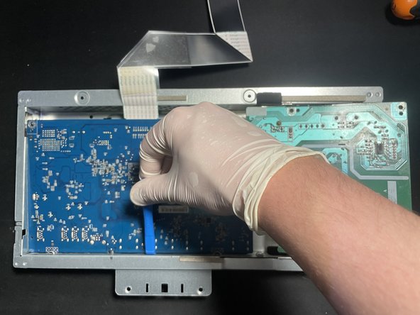

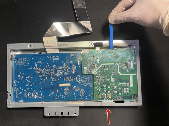

  4. Fix Dell U2415 Flickering Display, Disassemble control unit and power supply: crwdns2935265:04crwdnd2935265:01crwdnd2935265:03crwdne2935265:0 Fix Dell U2415 Flickering Display, Disassemble control unit and power supply: crwdns2935265:04crwdnd2935265:02crwdnd2935265:03crwdne2935265:0 Fix Dell U2415 Flickering Display, Disassemble control unit and power supply: crwdns2935265:04crwdnd2935265:03crwdnd2935265:03crwdne2935265:0
    • Unscrew power supply and control unit.
    • Unscrew 2 screws on the power connector on the unit side.
    • Lift the power supply board (Green) - it might require some force due to thermal tape holding it.
    • Lift the controller board (Blue) from the top and then push it to free connectors.
    • Now both boards should be removed and places on the insulated surface.

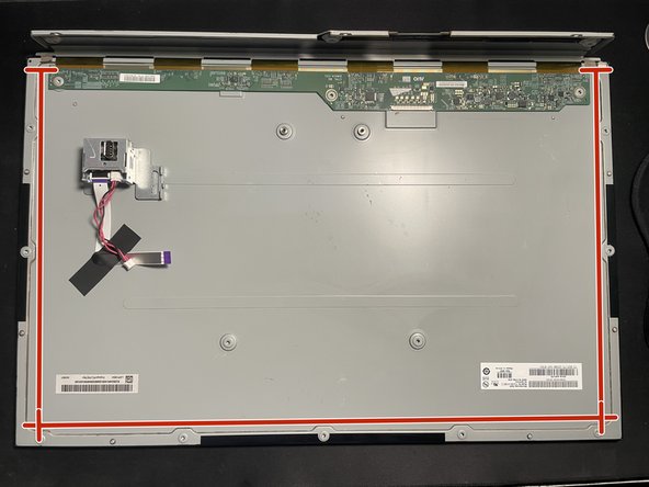

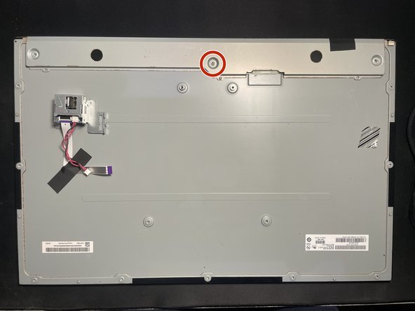

  6. Fix Dell U2415 Flickering Display, Remove outer cover and inspect backlight board.: crwdns2935265:06crwdnd2935265:01crwdnd2935265:03crwdne2935265:0 Fix Dell U2415 Flickering Display, Remove outer cover and inspect backlight board.: crwdns2935265:06crwdnd2935265:02crwdnd2935265:03crwdne2935265:0 Fix Dell U2415 Flickering Display, Remove outer cover and inspect backlight board.: crwdns2935265:06crwdnd2935265:03crwdnd2935265:03crwdne2935265:0
    • Unscrew all screws holding outer cover.
    • Lift cover to expose whole back of the panel and backlight board.
    • Unscrew the cover and lift it. Inspect circuit board for corrosion and treat it with the contact cleaning spray. Remember about the tape connector as it can have corrosion on its contacts.
    • Also remove corrosion from the panel shielding. It usually spreads from the outer sides as marked on the picture. Corrosion can spread to connectors and circuit board. Make sure you removed all of it. You can use high gradation sandpaper, but do not do it over the display.
    • Put backlight board on it's place and screw it back.
    • Put back outer cover and screw it back. Remember about 4 little screws.

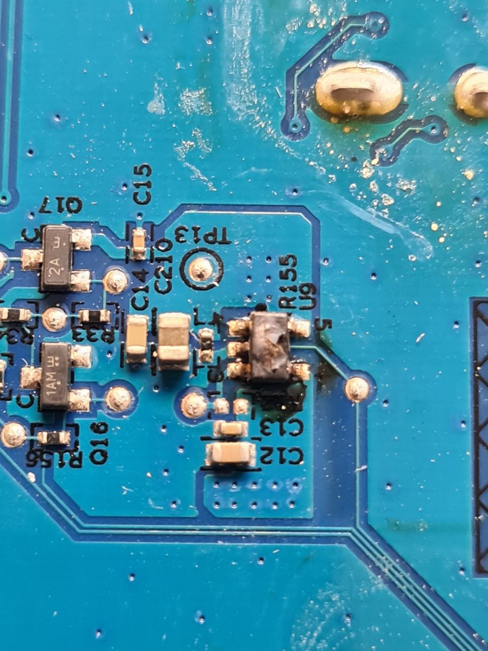

helllo
The damage is that the monitor turns on, the backlight flashes for a moment, the on-screen menu appears for a second and then goes out. Checked capacitors, checked power supply and its voltages. The power supply outputs 18 V and 3.3 V (probably on off) and the voltages are constant. All ribbons and connections cleaned. The power LED lights up normally and can be turned on and off by pressing the button. The given signal from the computer does not wake up the monitor. If you can't go in and see the menu, it's obvious.
tdrozd - crwdns2934203:0crwdne2934203:0
I managed to fix it. Shorted 470nF capacitor on the display board
Having the same problem. Could you point out the exact location of the capacitor please?
Anton Bogomolov -
hi
does anyone have a main board schematic for a Dell P2412Hb monitor?
My monitor is damaged, I found the culprit, but I need a hint. Is anyone able to tell me what this component is or indicate a replacement?
https://www.badcaps.net/filedata/fetch?i...
